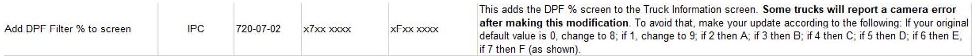

Originally Posted by Ricohman
Well, Dealer number #1 wants me to print off instructions as they have no idea what to do.
And dealer #2 says they can probably do it but will charge 1 to 1.5 hours or about $200 with taxes.
Anybody have a link to some easy instructions? Maybe I can get this done for under $100 if I can tell them what to do!
IPC DPF
To me it is worth spending $29 on the good FORScan adapter instead of paying a dealer for this.
But if you aren't comfortable with that, you can look at the FORScan Spreadsheet thread and ask them to make changes.
