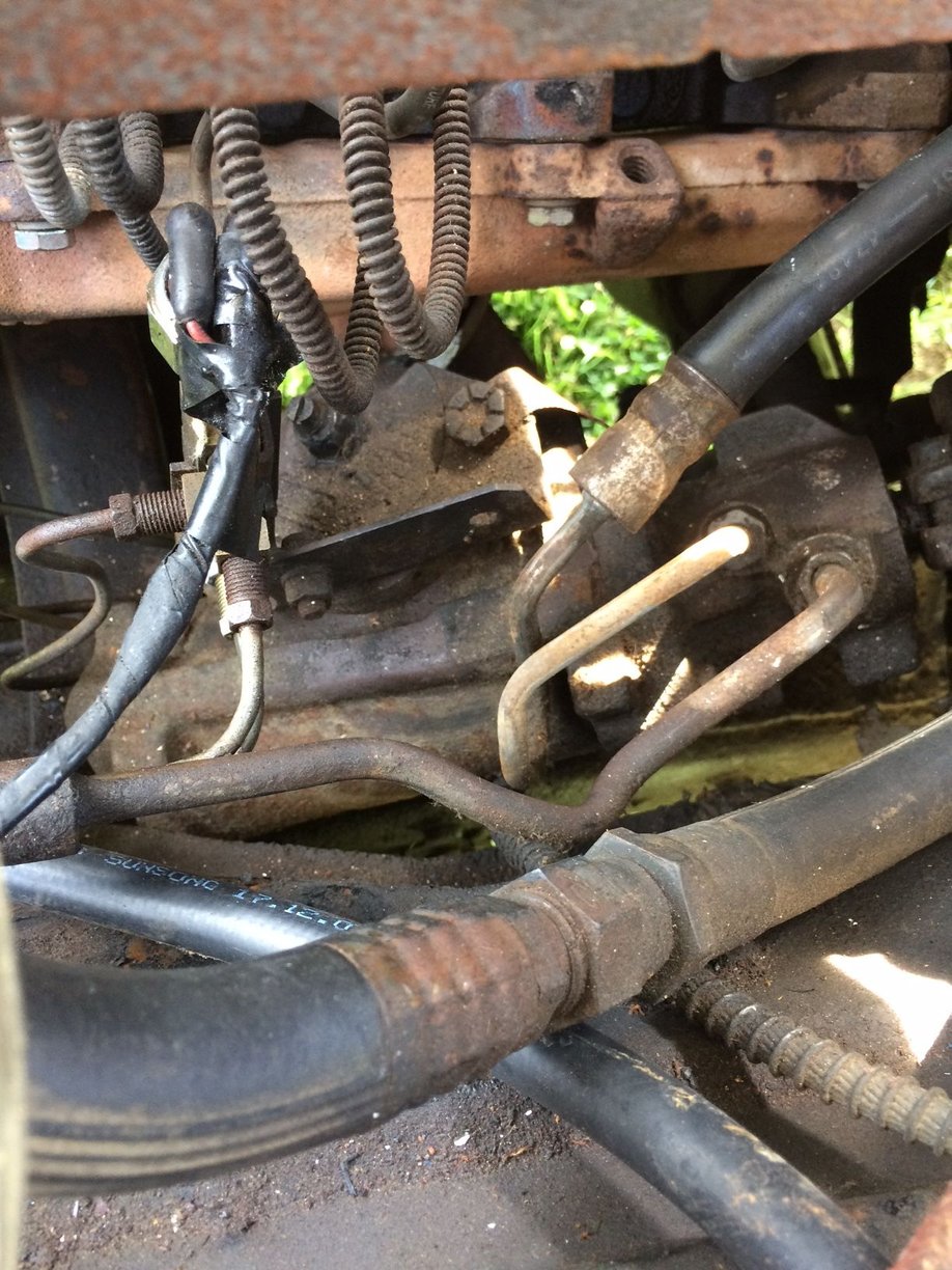

I just bought this 65 F250 truck in February. Discovered it had a 68' 390 in it, a 69' 410 rear end, hydro boost, power steering and a/c as well as 67' hubcaps and tailgate . It was sitting since 2003 I changed belts hoses, fluids and tires among many other things and finally was able to drive it yesterday. I put about 50 miles on it ran well maybe a little warm but the gearbox seems to have a little too much play as everything else seems in good shape any idea on how to id what year gearbox this may be. Thanks

The N indicates it came with an NP435 4 speed. If it's original to the truck it will not have a provision for a back-up light switch. If it was swapped in from a later truck ('67 up) then it will have the switch in the case.
