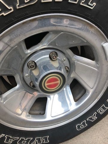

Somehow one of my center caps came off in the last week. I have no idea when.
Is this the original style? I was looking for another one and listings I saw said it was for a Bronco. I'm wondering if these are correct for my truck (92 F-150 XLT 2wd)

yes they are. There are red caps and black ones. You might check on that with the seller. The caps are held on by the three flat head screws so you might check your others. Sandy

Thanks. My truck is White and red so the red caps look good. I will definitely check the others. The odd thing is only the center part came off.

Those can be purchased individually. I think Rockauto has them but not sure. I know someone does or check Ebay. They are replaced by pushing them in from the front and RTV or whatever you like to hold it in the back side. They are hard to get out without breaking them so yours may have had a helping hand. Sandy

I saw both red and black center in the LMC catalog
but I know nothing of the quality:
Truck Parts and Truck Accessories
and Bronco wheels are the same as F150.
As far as I can tell
red centers are correct for pre 93
black centers are correct for 94-96

Lawsnook you mentioned yours were faded. Mine were also on the 94 I just sold. I sanded them and painted them silver. I tried black and it looked like a hole and I tried red and it looked like Rudolph. If you would like to paint yours, PM me and I will tell you how to remove them without breaking them. Sandy
