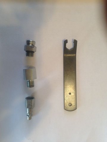

A good, quick way to check the condition of your cylinders/rings is to turn the oil fill cap upside down and place it on the fill tube. If it just sits there and rattles around you're not leaking compression into the crankcase, if it blows off due to pressure coming out then you have an internal problem. The Cody test you blow air pressure into the HPO rails and listen for air leaking out inside the VC's. I ran one and didn't have any leaks so I can't tell you what it sounds like but it is supposed to be pretty audible. When you do it it can get messy as the air pressure has nowhere to go and oil can, and will blow out on you during the process. I got some fittings and can hook my air quick disconnect right to the STC fittings on the HPO lines then turn the air in and not make a mess. For the HPO hose removal I got a wrench from a circular saw, cut a notch in it for the tubing and ground the tip down to facilitate getting it onto the hose. It beats fighting with screwdrivers and is a lot cheaper than buying a tool and it works awesome.

Here's what I got, I had a fitting here from a pump and bought the adapter from the ORB to NPT so the air hose fitting can connect to it. Then you can take the hoses off at the pump, it's easier than getting at that one on the passenger's side. That wrench notch isn't pretty but it works.
