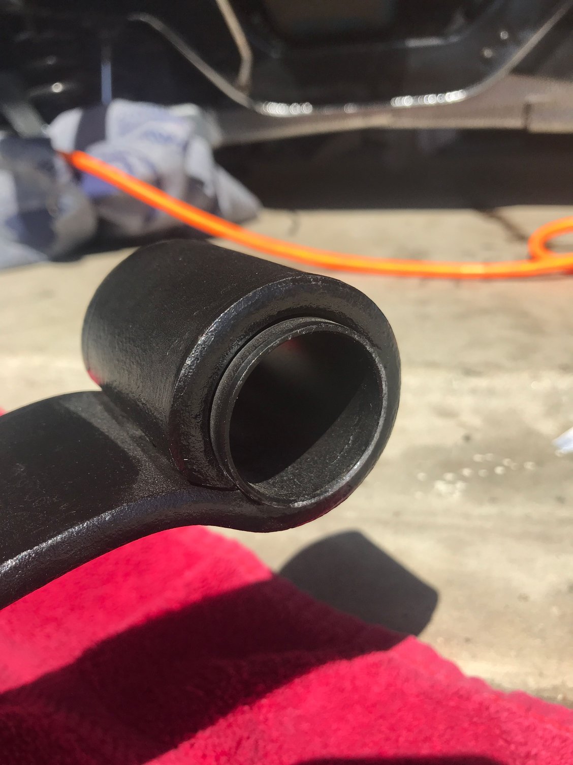

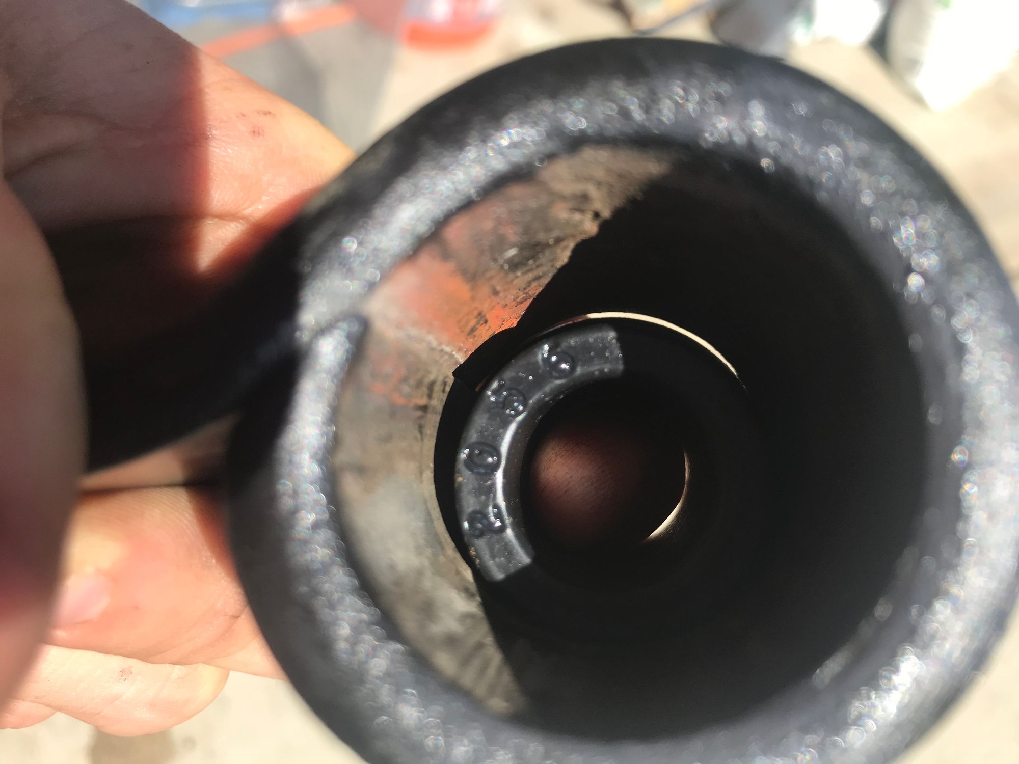

Good afternoon everyone I come to the form again to seek advice. I recently ordered energy suspension bushings (4.2113g) to replace the old bushing in my leaf springs. I was able to get the old bushings out however the new bushings have a smaller diameter than the leafspring islan I was able to get the old bushings out however the new bushings have a smaller diameter than the leafspring Eye. After doing a little bit of research I have noticed some leafspring bushings for our trucks come in a premade metal sleeve and after looking at my lease springs I believe those are the types of bushings that I had in the leafspring before. I also noticed that only 60s model trucks had those types of pushi after doing a little bit of research I have noticed some leafspring bushings for our trucks come in a premade metal sleeve and after looking at my lease springs I believe those were the types of bushings that I had in the leafspring before. I also noticed that only 60s model trucks had those types of bishings. I bought the truck you and I’m wondering if the original owner swap leave springs . Also the energy suspension instructions stated that the outer metal collar had to be removed.

I don't know if this will help you but here it is. I replaced all 12 spring bushings in my 72 F250 4wd.
Rear bushings part # RB 110. Two required. 1-3/8 O.D. 9/16 I.D. 2-3/4 length over all. For top end of hanger.
Rear bushings for leafs. Part # RB 101. Four required. 1-1/4 O.D. 5/8 I.D. 2-3/4 length over all.
Front bushings. All 6 the same. Part # RB 102. 1-1/4 O.D. 9/16 I.D. 3-3/8 length over all.
I just ordered them from the local spring shop. Once I did the leg work and came up with the "RB" numbers it wasn't a problem for them.
My truck is original so these are the correct ones. And they were tough to do. However, well worth it.
Hope this helps.

If the truck has Flex-O-Matic rear suspension, it using different diameter bushings.
All original spring bushings have a metal sleeve with rubber bushing.

I went with energy suspension bushing kit. I had to be careful which kit I chose.
Their kit for does not mention Ford Flex o matic but says three bushing rear shackle.
Ford also had a regular style two bushing rear shackle in the heavier gvw f100’s

Here is some Bushing info:
C8TZ-5781-B .. Flex-O-Matic Spring Bushing / 1 3/8" O.D. x 5/8" I.D. x 2 3/4" long / Obsolete
If that is what you need a machine shop can make 'em. They should be cheap.
