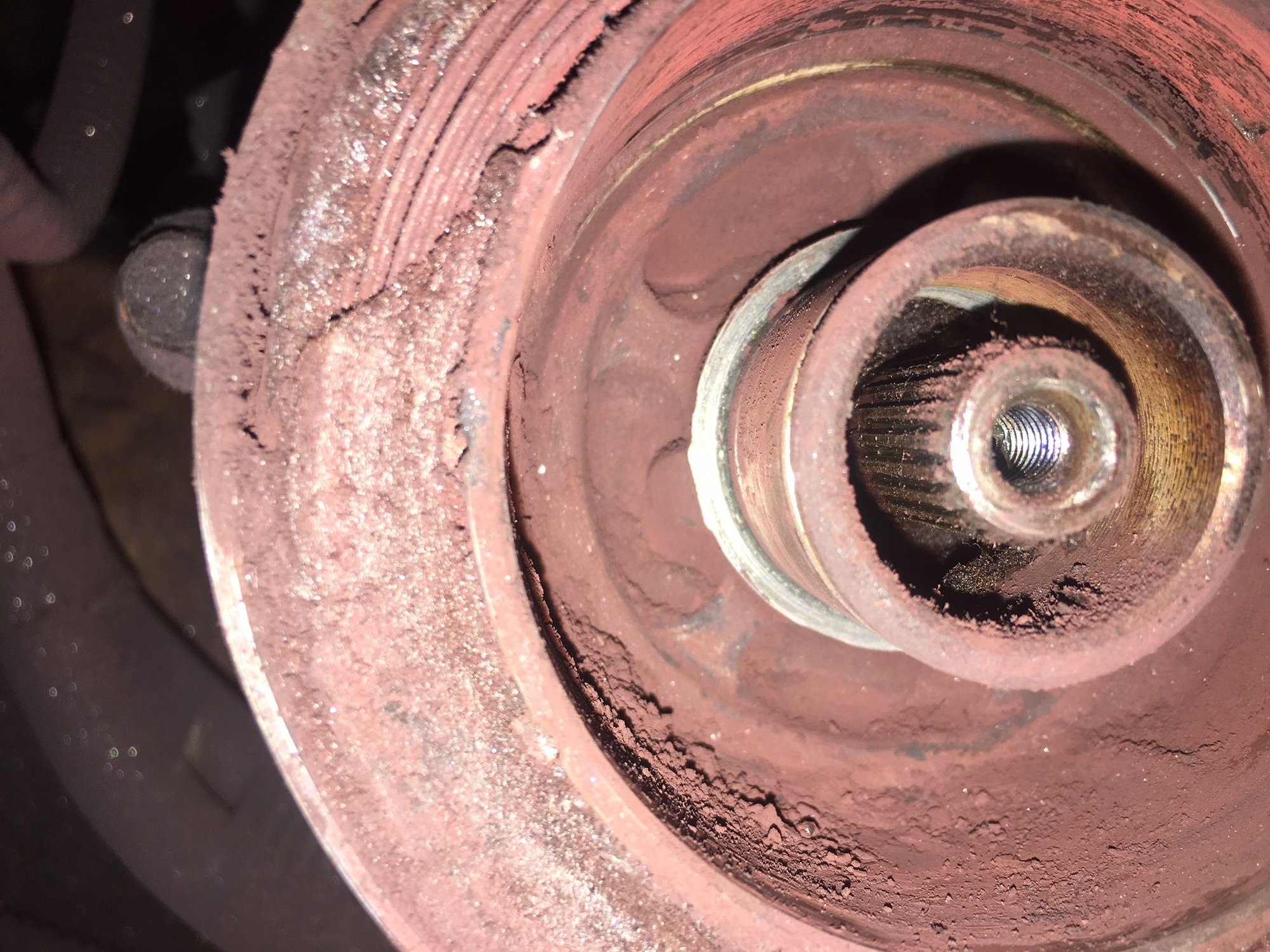

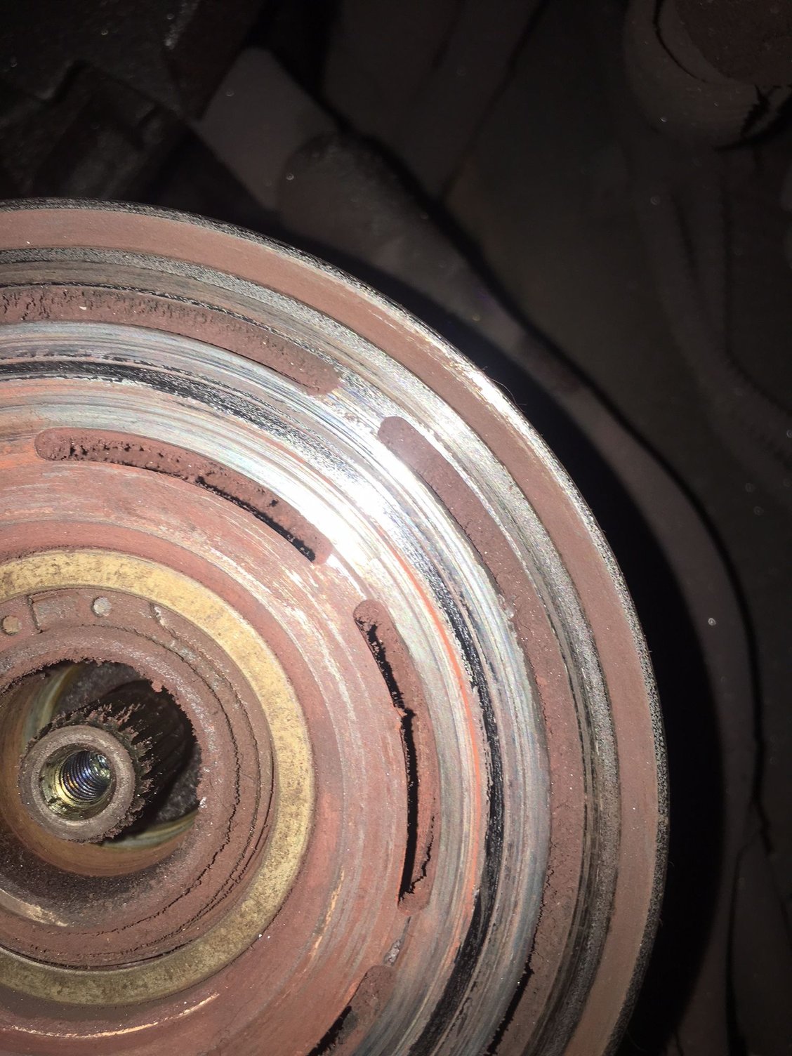

I'd say that if it's clicking whether or not the AC is on, the bearings are likely going in it. Mine had ball bearings in it that essentially came out of the carrier but remained in the pulley and then got all crammed together and locked it up so bad it kept the engine from turning over. I did use a gear puller, but other than that no special tools. I' would think that if you were to take the belt off, you could spin the pulley by hand to feel if it's binding and go from there. Mine is a two piece (essentially), such that when the AC is off, the belt running surface spins freely. When the clutch engages (AC on), the clutch collapses on the outer ring (belt running surface) and spins the compressor itself. You may not be able to spin the compressor, but if the out ring (belt running surface) is binding, that's where I'd start. Mine was pretty rusty and nasty, as you can see in the pictures.
