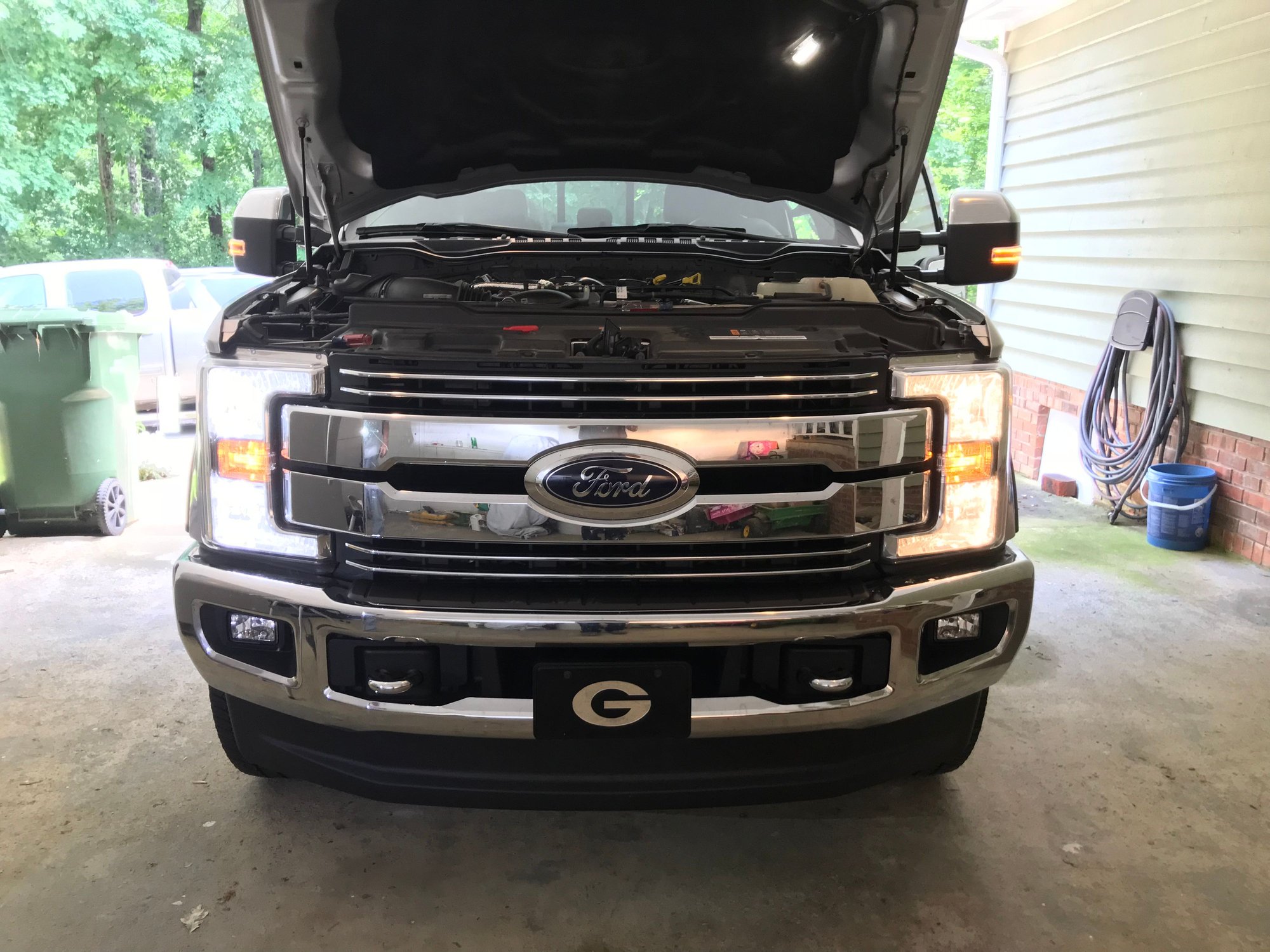

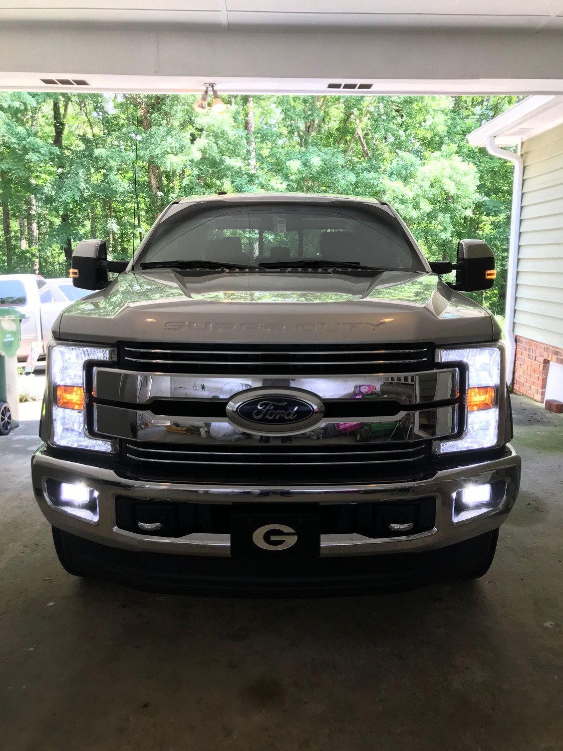

I did the heads and fogs that were referenced in the other thread. I only removed the snorkel on passenger side and the washer fluid fill tube on the drivers side. Super easy 30 mins start to finish. I highly recommend these.
