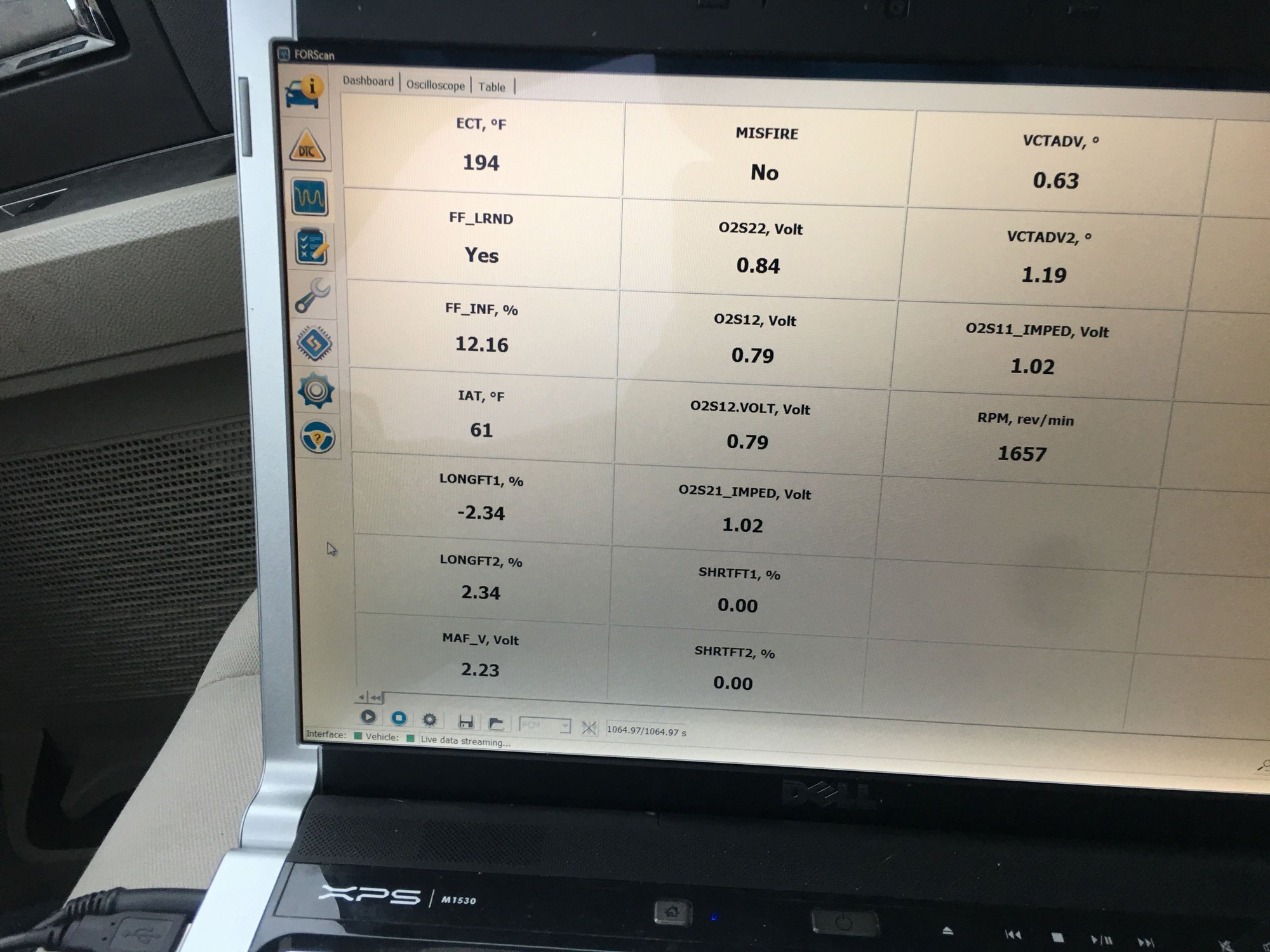

I have an ELM327 scanner and the FORscan software. Image is from my drive to work the other morning. Cruise set at 60mph. Engine was up to temp. Any techs or wiser than me folks willing to offer a point in the right direction? Additional PIDs to monitor?

It does indeed look like you might have a vacuum leak. Notice the fuel trims. Bank 1 is trying to lean out, and bank 2 looks like it's trying to go rich (if the + and - are rich and lean, I don't remember). Either way, the computer is trying to adjust the fuel mix much differently in each bank.
A vacuum leak on the bank 2 side would cause it to try to richen up the mix on that side. Or there's too MUCH fuel on bank 1.
HOWEVER, I see you disconnected the solenoids and it runs perfect now. That might mean one of the solenoids was bad, but the computer would normally throw a code for that if the cam is not timed according to what it wants. You might have just covered the problem with a band-aid because you put the PCM into open loop (check engine light is on, right?). Check the fuel trims with the solenoids disconnected, I bet they are the same now

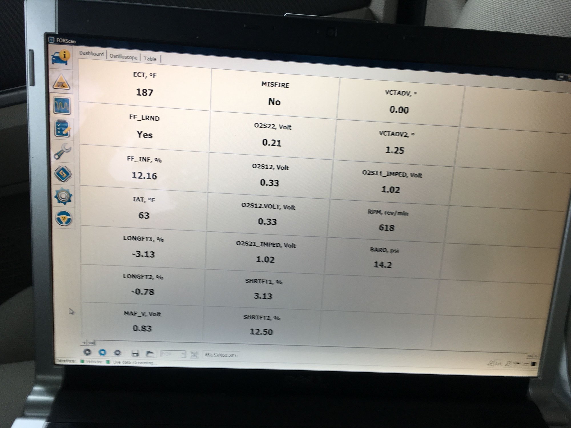

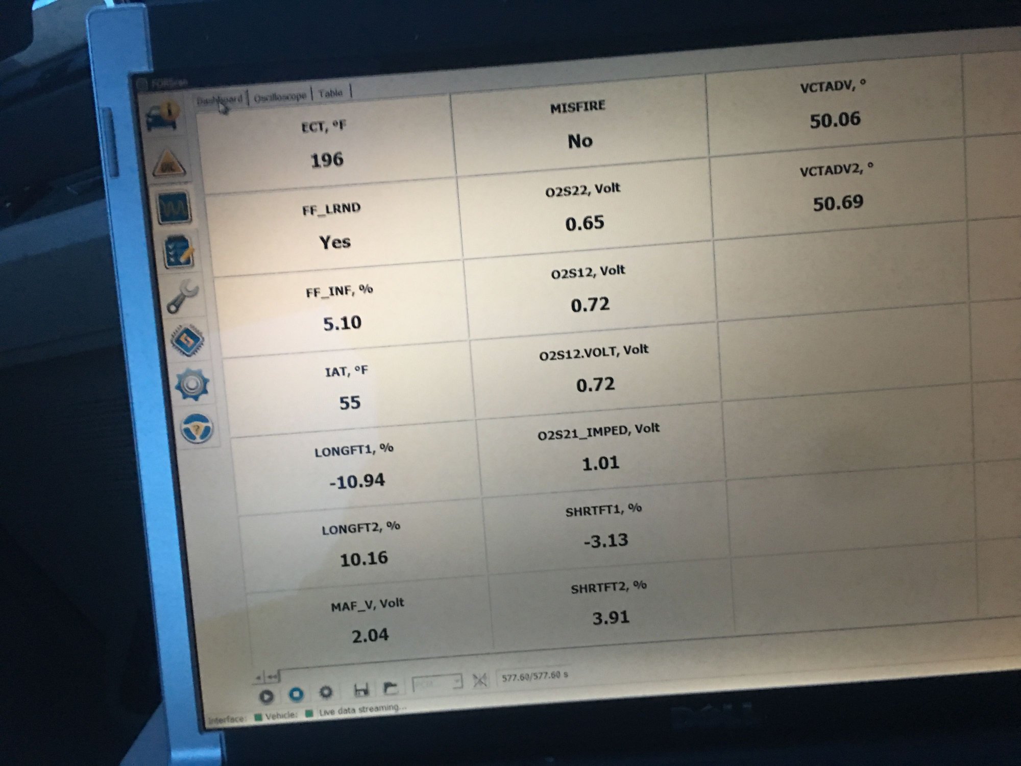

Fuel trims did even out quite a bit. One picture is same conditions as before. Flat level road with cruise set at 60. Other one is idling in my driveway.
