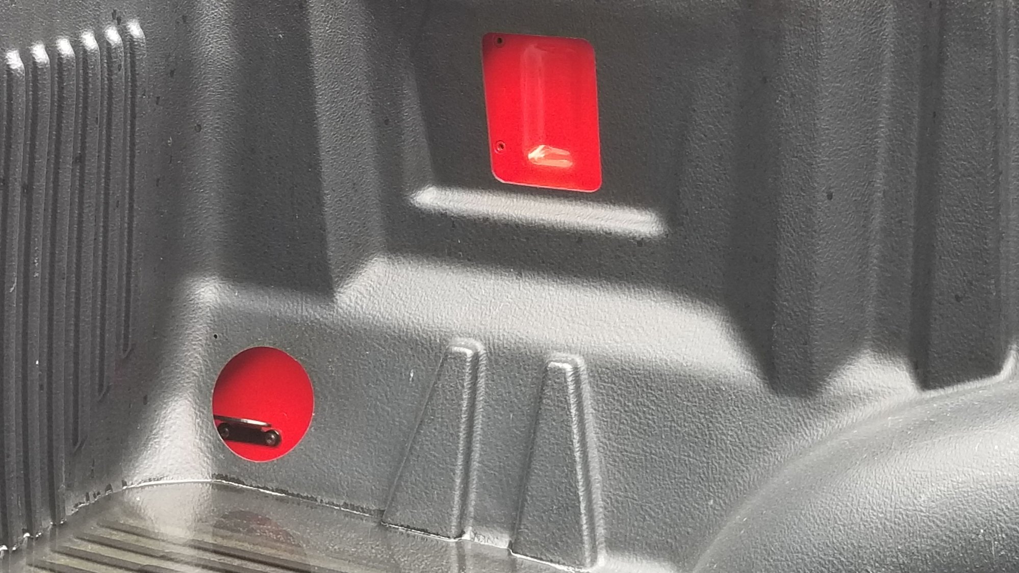

2018 F-150 w/ 8' bed. After delivery I noticed that there are four locations near each corner of the bed where a cargo hook would go. There are four unthreaded holes in a square pattern at each of these locations.
So my question is how may I use these mounting locations to retrofit cargo hooks? Does Ford offer cargo hooks that can be attached to these locations? Are there third party products that should be considered? Also, I am about to get a sprayed-in bed liner so is there something I should have them do to preserve my options?

As OEM on all trucks (?) you should have tie down hooks near the floor on the walls in front and back of the bed.
Optional is the "Box link" setup, which uses plates that attach to the mounting spots you describe higher on the inside walls of the bed. The plates and hooks are available from Ford or elsewhere:
https://www.ebay.com/itm/Ford-2015-2...-/112016512725
Google "ford box link accessories" and you will see the plates, the hooks, ramps, bed divider, and other aftermarket items that attach.
I would get the plates and thread the holes before a spray in, or at least ask the bed liner people to mask off the holes.
Threading them sounds easy but I found I will have to pop my drop-in bed liner out to be able to do a decent, straight job of it. I think I'm going to unload that and go another way on the bed liner anyway. But I digress.

Originally Posted by GlueGuy
The four corners on the floor? Ours came with hooks (or "loops") installed at each corner. I had no idea they were bolted in; all the times I've looked at them, they appeared to be welded in. Now I have to go look.
Here's a picture of one of these.
Old May 12, 2018 | 05:19 PM
85e150's Avatar
85e150
Joined: Apr 2004
Posts: 34,518
Likes: 2,826
My truck is exactly as pictured here. I have the plugs for the bed liner, in a bag with the box of box link stuff.... I'll get a round to it soon.
I did not get such a bag so did I get short changed or are these fixtures optional? I did get the towing package for something like $995 and that was listed on the window sticker.
Sorry to word it in a confusing way. The plugs for the bed liner are in a bag. I have yet to pop them in. The box link stuff is in a box. I bought those from the dealer after the sale. (my truck is an XL) Both items are waiting for me to install or whatever, when I get to it.
In your case, IF you had box link, it would be on your window sticker. The plates would be on the bed walls already, and the "hooks" with the key would probably be in the cab as suggested above.
