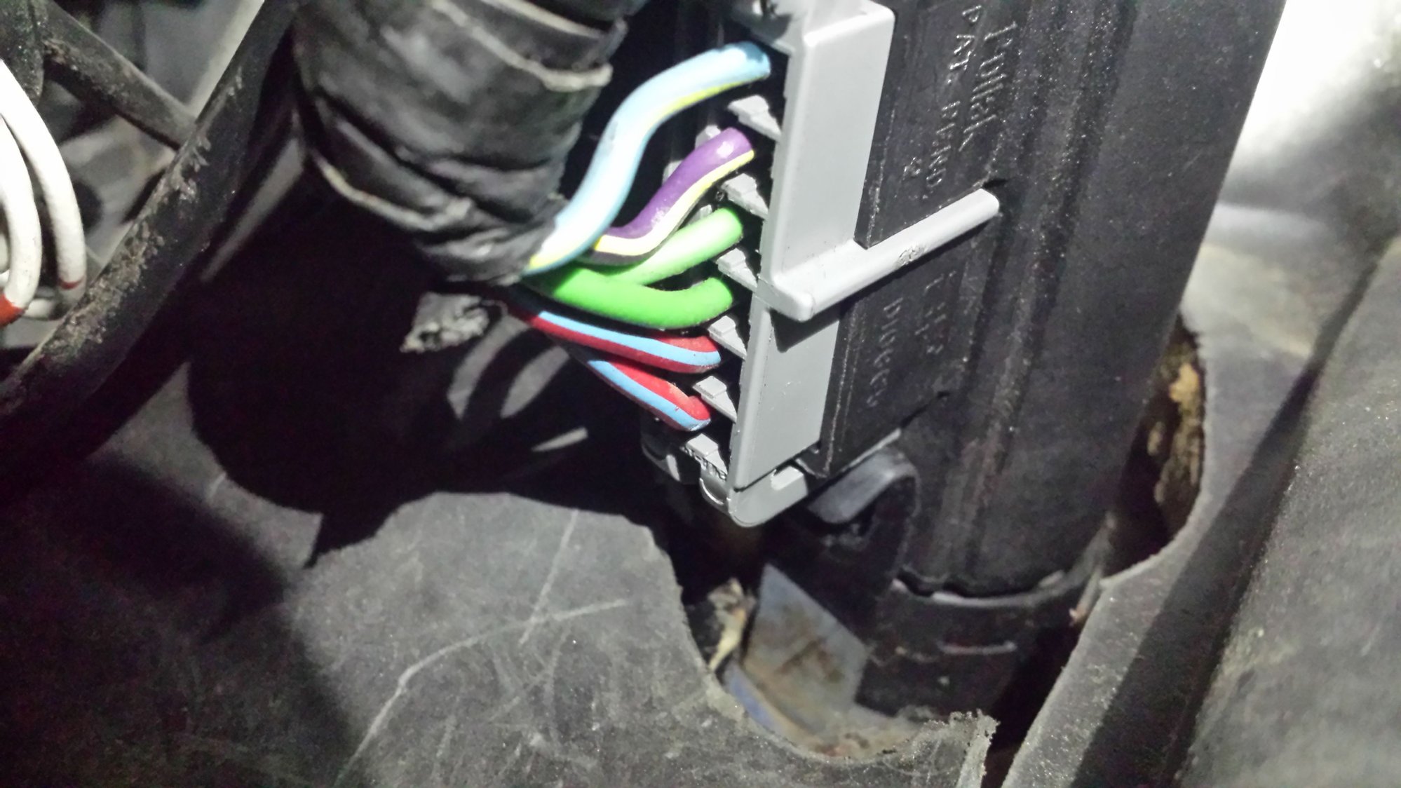

Here is a photo of my plug.....anyone bypassed this one before?
top-bottom blue/yellow purple/white green green red/blue red/blue

Looks like easy enough access in your case. Give a small jumper wire a try. Looks like you may not even have to unplug the connector.
Just push the wire into both cavities with the Red w/blue wires from the outside to temporarily jumper them together.
Crossing fingers that's the issue, but if not at least you're narrowing things down.

Hmm, now that I look at the diagram, better wait for someone more well versed in modern electrical setups on the Fords.
On early models, it was a simple matter of jumping the two sides of the Red w/blue together to complete the circuit. Not sure that's how the switch works in your case though. Hopefully someone can confirm or deny my previous answer.

Just use a multimeter on the continuity setting put the leads on both bl/r wires and depress the clutch. If it goes to continuity then the switch is closing and making contact. Then, go from one wire to ground and hit the key and look for voltage. And repeat with the other. If you get 12v at each then the problem is some where else.

I have continuity on the red/blue wires but I only have power to the solid green wire next to the red/blue wires......no other wires have 12v with key on and clutch down or up
