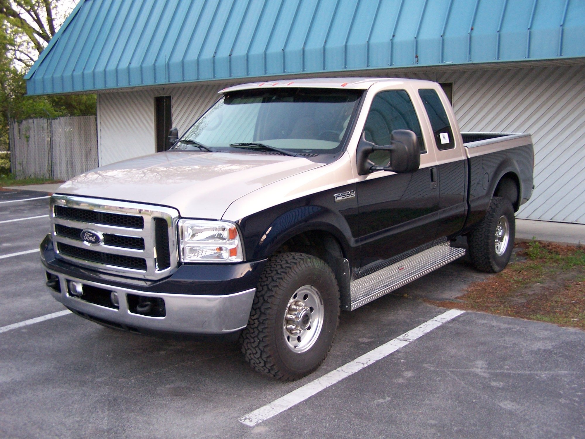

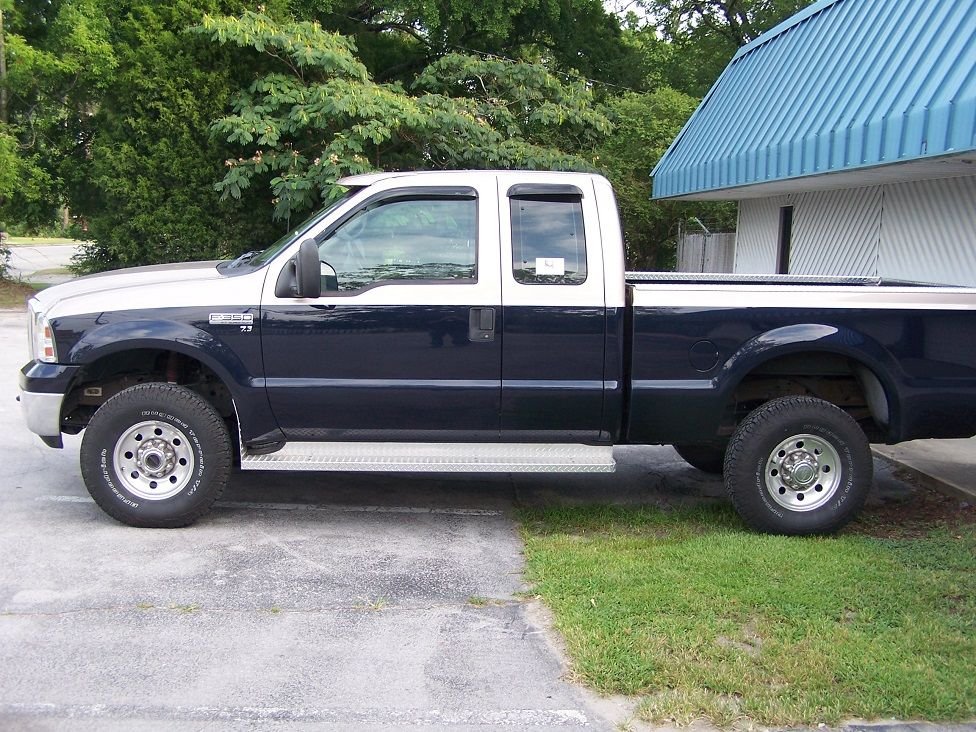

I did it a while ago mine is all factory I just cant put Chinese parts on my trucks if I can help it! heres a couple pics. it wasn't to bad to line up and I thought it looked good. truck is a little bigger now but still looks good

Here are the only pictures I have on hand and none are from the side. I believe mine do not line up exactly and I used all OEM parts for the project but they were not all from the same vehicle.
Here they are.....

Both of these look way better than mine. I just cannot help but to believe that the aftermarket brackets I have are the problem...…..I would be satisfied if mine turned out that nice!
Thanks for the great pictures!

what I noticed when doing mine is they stuck out a little from the fender like they were made to line up with the flairs like tim has . and they wouldn't go all the way back to line up the curve in the wheel well perfect but its close and gives you a little room for a bigger tire. a/m stuff sucks not custom a/m but cheap oem alternatives and I order 5 to 10 k worth of these junk parts a month because the insurance companies don't want to spend the money to fix it right just how is the cheapest way out is there goal ! you should be able to slot the holes in the frame or the brackets to get them to work.or can always break out the BFH! hope this helps
