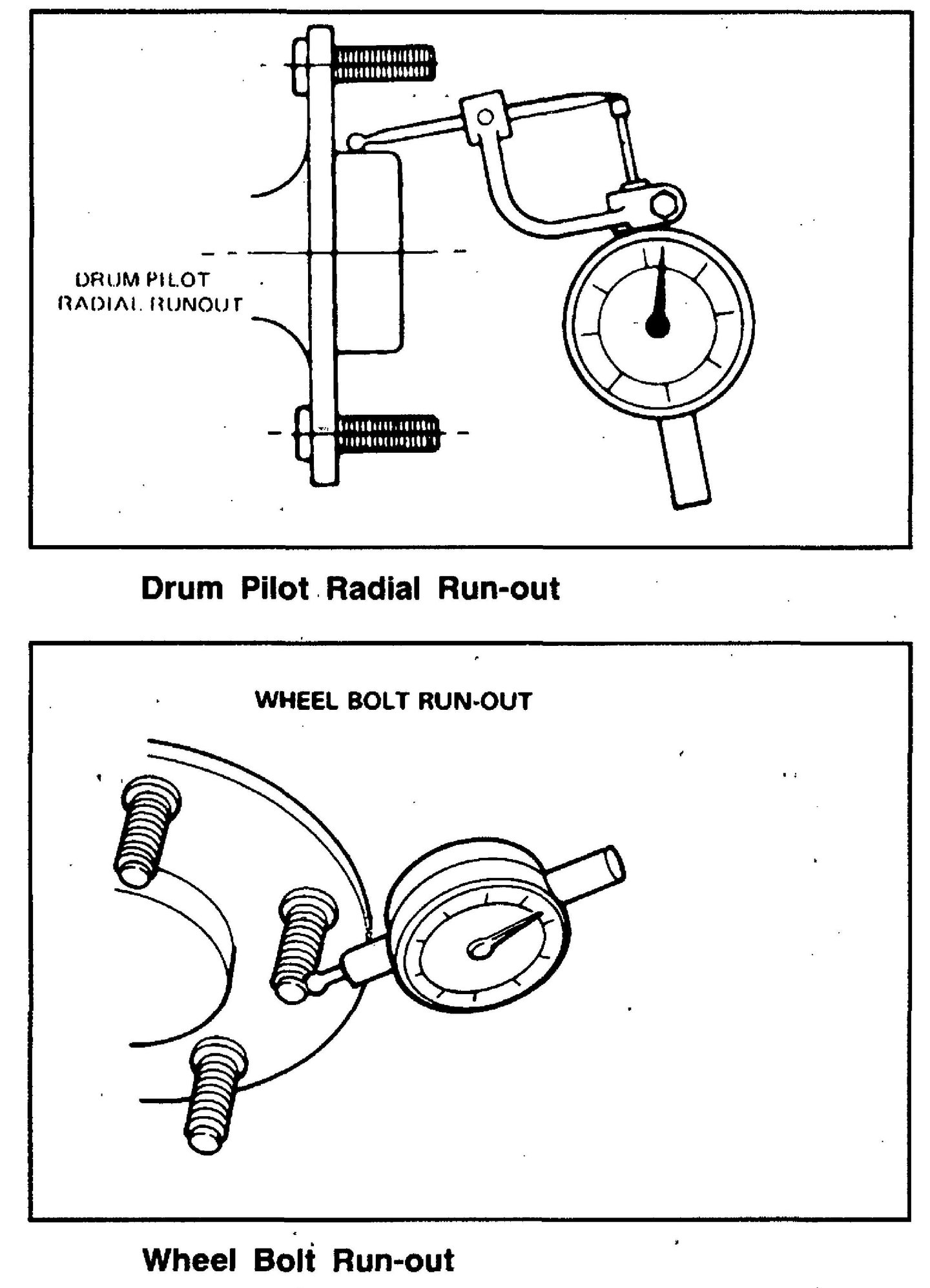

Well, well,,, Learned a good bit today. The drive shaft shop used a vibration analyzer and said it was the left rear wheel. That is the same side I put a new ford axle in I bought off of Ebay.
I stood at the back of the lift and you could see the same slight wobble in the tire that I saw when I first bought the van. There also appears to be a slight up and down in this one, I don’t remember seeing it last year when I checked that wheel.
I know when they rotated and balanced the tires yesterday that they moved the one what was on the left rear because I had a pen mark on it....
Twice now when they balanced the tires I told them to look for any runout on the tires or wheels.
There was one I thought might have a little wobble in it and had them to mount the tire on a wheel from my 85 E150 so I don’ believe it is in the wheels.
When we installed the new gears, bearings, and axle shaft, we didn’t bother to check the runout never thinking that a new axle would be bent or out of spec. Well I guess I will be checking the run out this weekend.
My manual shows 3 different run out tests for the axle. I do not have the adapter to do the drum pilot radial runout though. I guess I cold remove the studs and check it though.
I guess the chances of buying a NEW OEM Ford axle shaft on ebay that is bent or out of spec might make it a bit easier to accept that two axles could be damaged...
Any other thoughts what could cause this?

I will be going back to the shop where we rebuilt the differential and do some swapping wheels and brake drums around as well as checking the run out on the axle.
We have been thinking about what could cause the wobble in the wheel and the only thing I can come up with is either a bad brake drum or the new axle shaft is bad.
Had this problem before the differential rebuild and new axle shaft. That is part of the reason we did all the work.
If the axle tube was bent the axle shaft should still run true unless it was bent enough to physically see it. .
I could see some wobble if the spider gears were worn at the carrier but all that is new.
We checked the run out on the new carrier and it was fine.
Read is the brake drum is badly bent or extremely rusty it could cause the surfaces not to fit flat but there is only minimul surface rust on the drum and no signs of ever being pried off...
I did a little more research on the Ebay sellers store and he runs a salvage yard so even though the axle shaft looked new, I guess it could have been a take out... We will see..

We checked the runout on the axle and wheels, not the tires, and everything seemed to be within specs. I had automatically assumed the left axle shaft was bad before we did the differential rebuild so I did not check it very closely when we removed it. The other day I went back and inspected it and it defiantly had a bad bearing surface on it.
