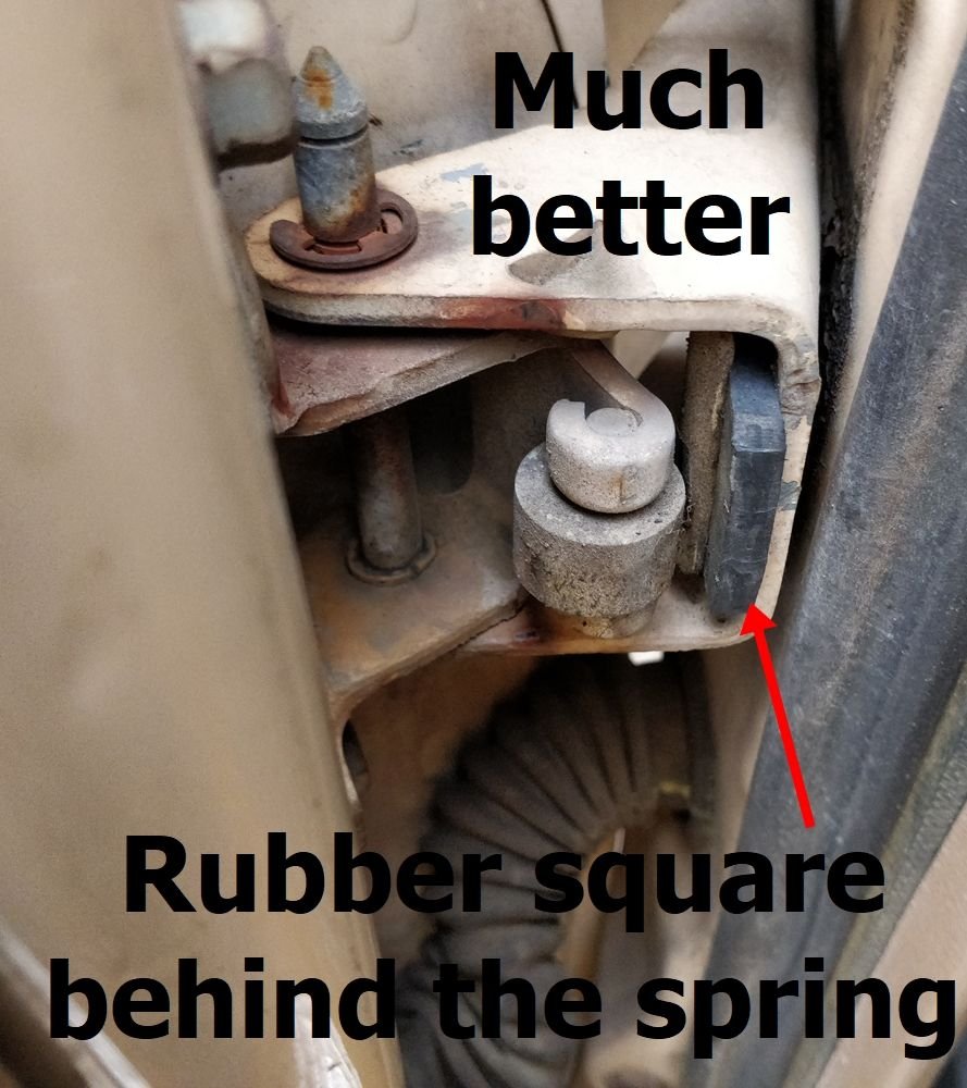

My driver door stop, which we call hoedeedoes in Texas, was very weak. The door would only stay open on level ground. Otherwise, the door would close on us. Annoying.
Here's a quick fix to make it better. Get a piece of thick rubber, such as conveyor belt rubber, and cut a fat square inch. Look at the pics below to see how to insert it under the old, weak hoedeedoe spring metal.
Cut a square of rubber, and force it in behind that weak old hoedeedoe spring
