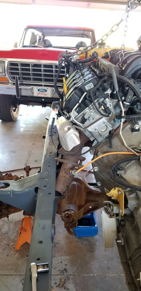

My motor is in the frame.
The stock f150 exhaust manifolds fit easily.
Well, motor is in. Mounts fit perfectly, which is good cuz I have a lot invested in them. Forgot that the stock oil filter/cooler location won't work at all, so I'm ordering a remote mount setup. Still making final decision on my pulley/power steering setup while I swap to the Mustang timing cover. I'm more focused on the suspension at the moment.

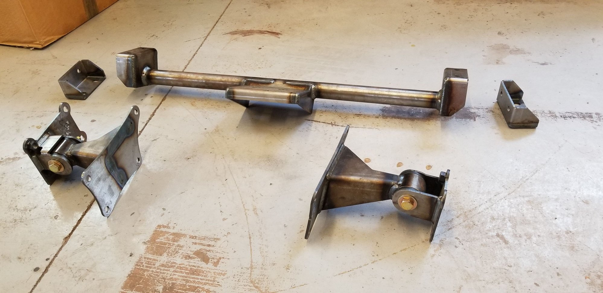

These are the Fat Fender mounts for 77-79 f250 4x4.

Will those work on a f150 dont really know the difference in the frames.
Old Sep 12, 2019 | 06:42 PM
  #120
Mr.shift's Avatar
Mr.shift
Joined: Jun 2017
Posts: 237
Not exactly. Very similar though. The point is they are about to be released.
