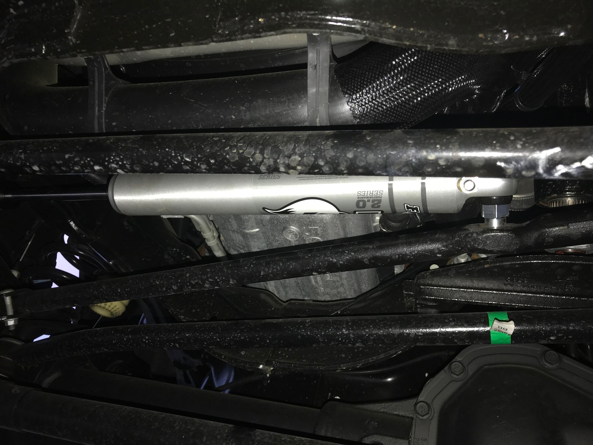

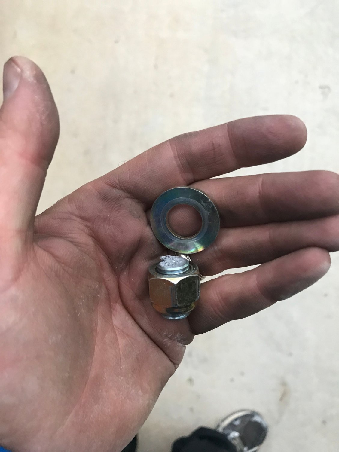

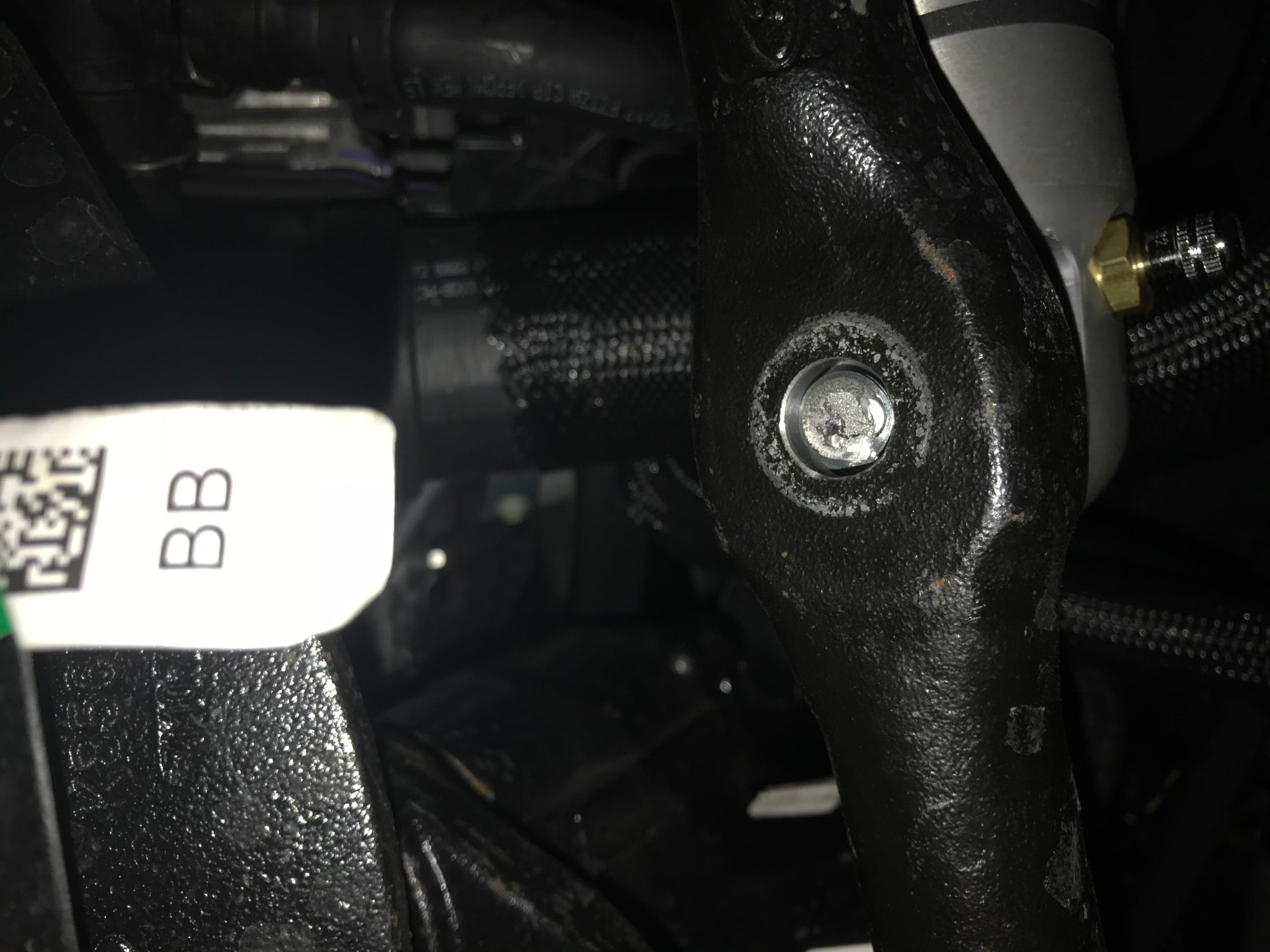

i was doing the Fox steering stabilizer install and broke the bolt that came with the Fox kit. I stupidly over torqued the bolt and it snapped off, now I can’t get the Fox stabilizer off. The pickle fork I used doesn’t seat well on the Fox bolt, it’s so tight the pickle for just spreads and doesn’t budge the stabilizer.
Should i drill it out? Use a two jaw puller to put pressure from the bottom? Or just say heck with it and roll. It’s pressed in there very tight and ain’t budging

Yes I have. First thought was to do that. Then added the pickle fork and punched the bottom. Was using a 2lb hammer to try and punch it out. Wouldn’t move.

Heat is your friend, use torch (propane will do) heat the Drag link bar around the stud and then use punch to drive out. It should pop right out.
Yep, I sure hate to do that. I guess I need to pull the drag link bar then.

Honestly, don't think propane torch is going to do anything here. Make sure you wear safety glasses when you are drilling the bolt out.

I used this (from Amazon) to remove the OEM steering stabilizer (also put on a FOX 2.0 steering stabilizer) ---
Heavy duty pitman puller Heavy duty pitman puller
You should be able to borrow/rent one from AutoZone or similar auto parts store.
I just cranked on the puller with a ratchet and the shock mount just popped off.

I agree with the Pitman Arm Puller. I used this one several times to remove mine.
https://www.harborfreight.com/tie-ro...ler-63684.html

Center punch and 5lb hammer
PS: were you not torquing it to spec? I think its like 68 ft/lbs. Or were you just using a 6 foot breaker bar and going for it?

I used a $15 pitman arm puller to get my old SS off. Took about 30 seconds. I think I got it at O’Reily

Bought mine at auto zone for around same price for another option.

Air hammers can sometimes be of use in cases like this. I've removed some pretty stuck fasteners with an air hammer and sometimes with the addition of heat.

in the end if you can't take it out - tac weld it and call it good.
