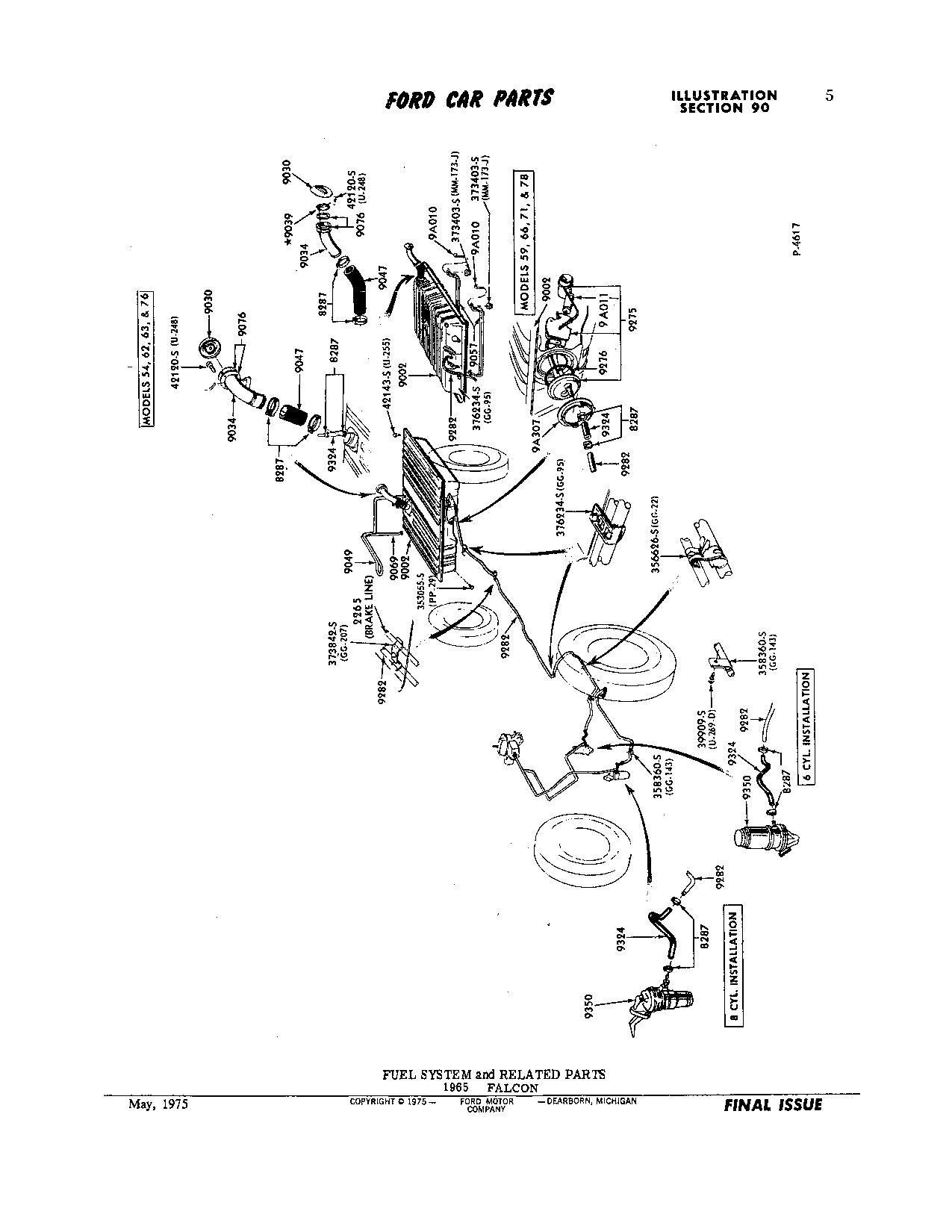

Originally Posted by matthewq4b
Ford Falcon 64-65.
Except Ranchero, S/D (sedan delivery) and S/W (station wagon).
See pic at upper left for matching fuel cap: 54 = 4 door; 62 = 2 door; 63 = 2 dr. H/T; 76 = Convertible.
See upper center in pic for Ranchero (66), S/W (59/71) and Sedan Delivery (78). Fuel filler cap located on the left quarter panel. It's a different shape than the other fuel cap.
