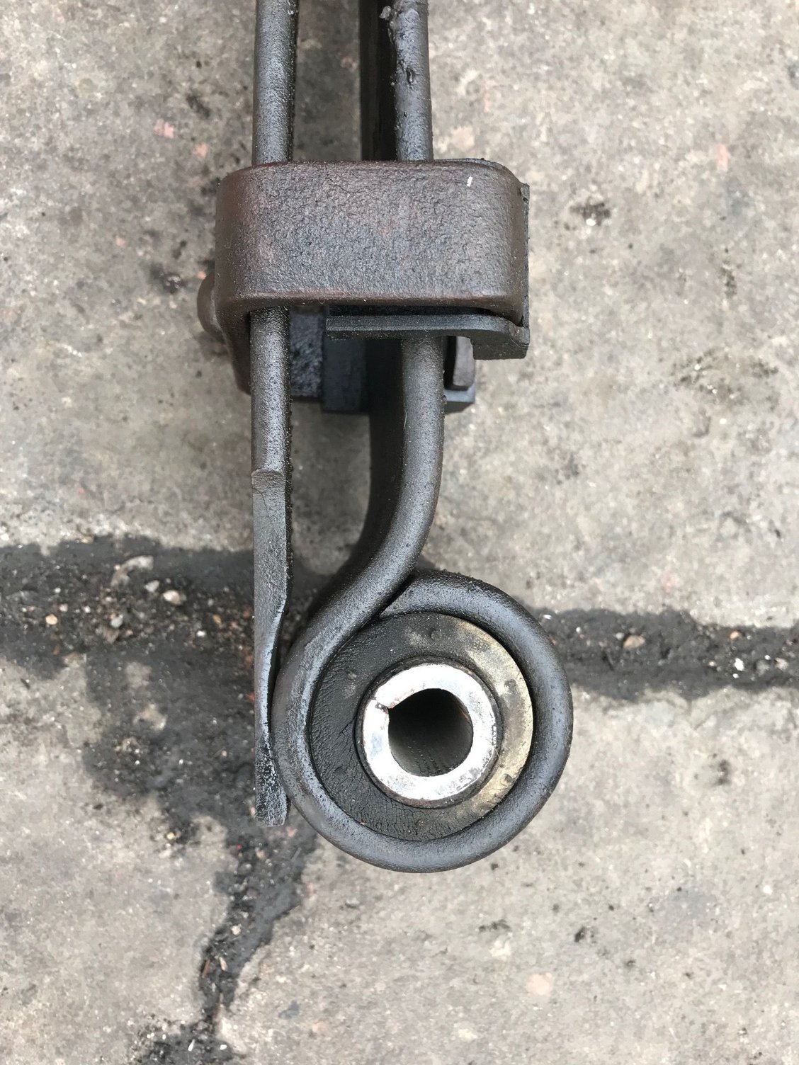

I went with 2 spring X-Codes from SD and am happy with the results for the price. I wasn't looking for a lift. It rides about the same as before and I have new Bilstein shocks.
The truck rides a tad higher, maybe 1" in the front... than it did before adding the bumper/winch.
Here is a shot of my old springs wear for reference:
