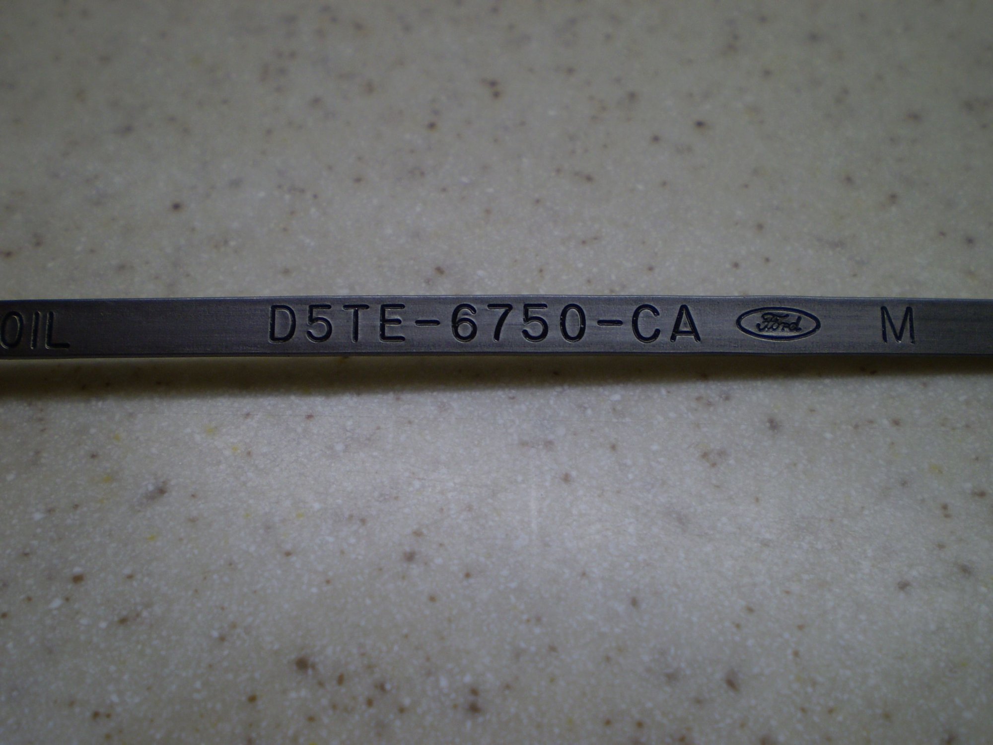

Dont get all excited with the title...... but im curious after an oil change today if i have the correct dip stick or if im just loosing my mind.. 76' F250 4x4 rear sump FE360 pan ? Book says 6 quarts, my stick is barely registering oil... Im I crazy here ? Could someone measure there dipstick that has the same configuration ?
Old Apr 8, 2018 | 10:21 PM
NumberDummy's Avatar
NumberDummy
Ford Parts Specialist
Posts: 88,826
Likes: 784
From: Simi Valley, CA
Originally Posted by jakeharp
Dont get all excited with the title...... but im curious after an oil change today if i have the correct dip stick or if im just loosing my mind.. '76 F250 4x4 rear sump FE360 pan ? Book says 6 quarts, my stick is barely registering oil... Im I crazy here ? Could someone measure there dipstick that has the same configuration ?
There's an ID engineering number stamped on the dipstick. If it's D5TE-6750-CA .. it's the correct dipstick. If it's something else, it's wrong.

Hey ND are there any old stock D5TE-6750-CA still out there ?
Old Apr 9, 2018 | 12:00 PM
NumberDummy
Posts: 88,826
Likes: 784
Hey ND are there any old stock D5TE-6750-CA still out there?
D5TZ-6750-A .. Engine Oil Dipstick / Marked with ID number: D5TE-6750-CA / Obsolete
1975 F100/250 360 4WD from serial number W00,001; 1976 F100/250 360 4WD
No Ford dealer or obsolete parts vendor has any.

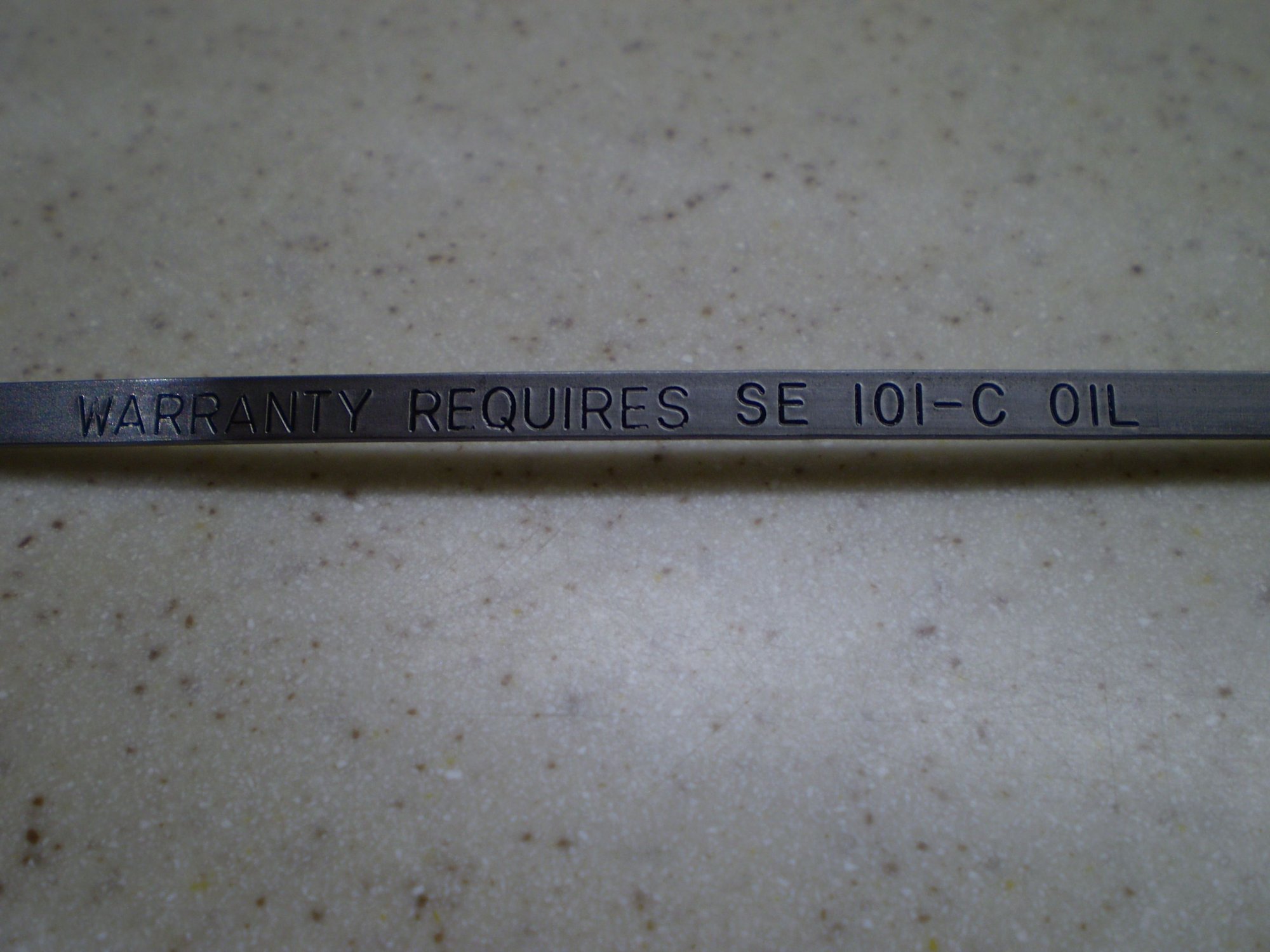

Old Apr 9, 2018 | 05:56 PM
User 71024's Avatar
User 71024
Joined: Sep 2005
Posts: 2,954
Likes: 64
just pulled the one out of my 390 and there is no part #, only thing it has other than the full and add markings is "Warranty Requires SE/101-C oil"

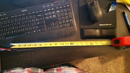

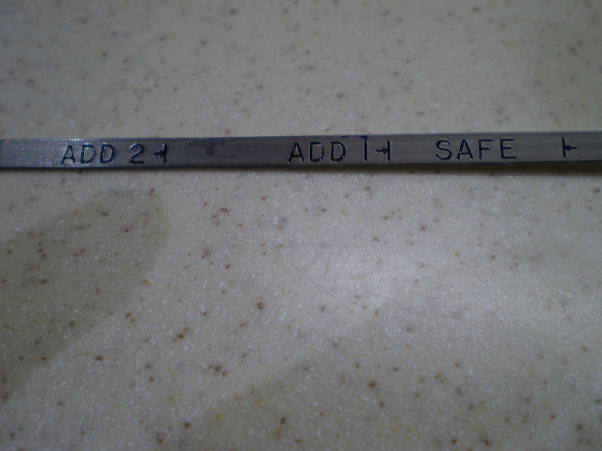

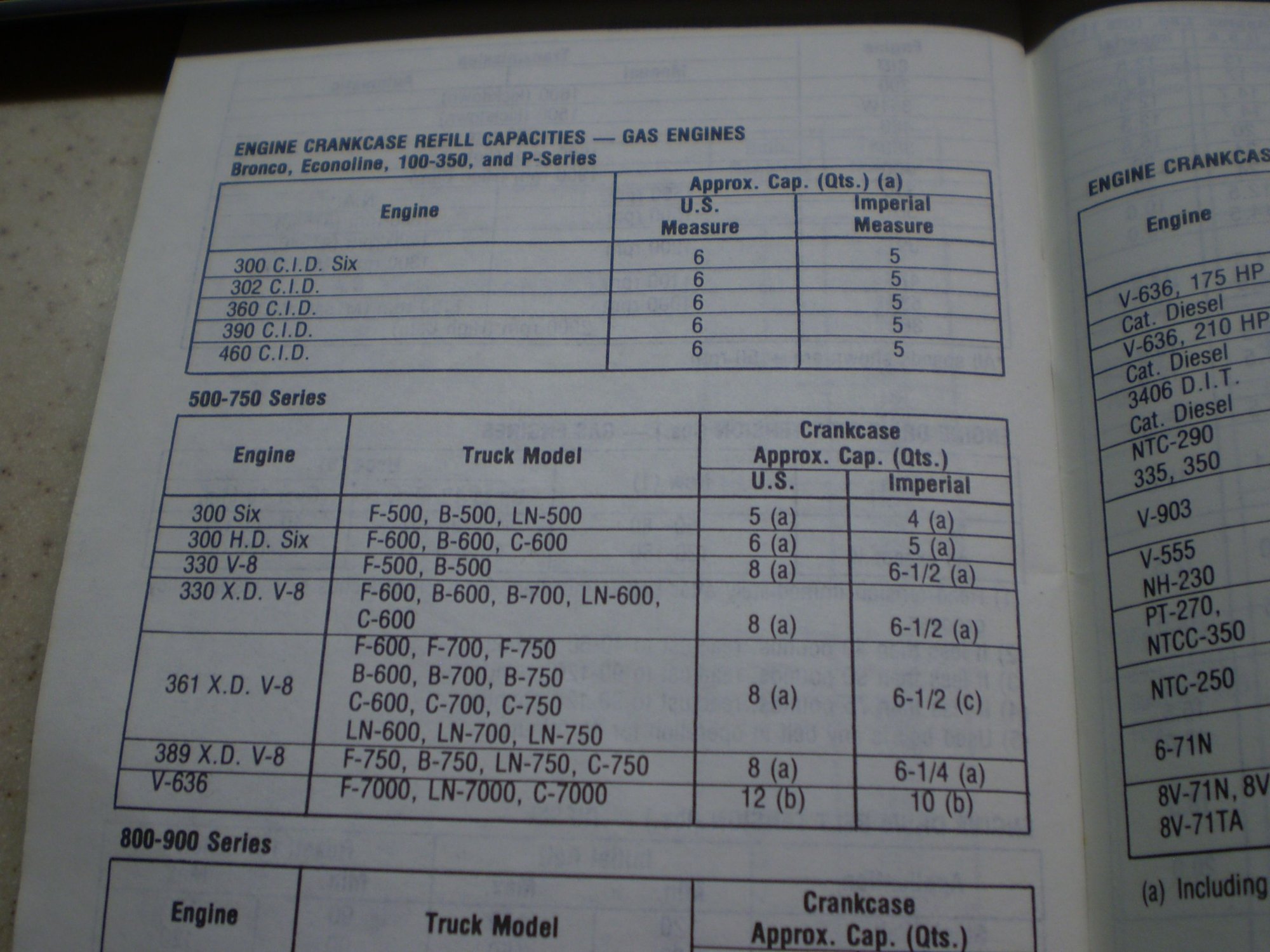

Old Apr 9, 2018 | 07:38 PM
hickory1991's Avatar
hickory1991
Joined: Feb 2011
Posts: 1,410
Likes: 42
From: Michigan
From my 76 Highboy with a 390 not 360. Had it built but same rear sump and dipstick from original 360. Shield to full 17 13/16. Shield to add 1 qt 18 13/16. Shield to add 2 qt 20 1/16. Shield to end 21 3/4. Just changed oil in mine and 6 qts with new filter is just above add 1 qt. In my spec book 360,390 call for 6 qts. Asterisk "a" at Approx. Cap. {Qts} top of page says Add 1 qt when changing filter. Maybe ND can confirm this.
Old Apr 9, 2018 | 09:12 PM
jakeharp's Avatar
jakeharp
Joined: Aug 2004
Posts: 1,311
Likes: 31
From: Nevada
Thanks
Interestingly enough my stick is measuring identical to Hickorys to the add and full marks with exception to total length, mine is only 19" My truck was also upgraded to the 390 by the last owner (have receipts) but that wouldnt change the oil pan, I now have 7 quarts total in the pan with a fresh filter and still only shows at the ADD mark........ no major leaks, no smoke when starting, great oil pressure (for an FE)....... beginning to think i put a bend on the tube when I re-fitted it during rebuild or maybe I have and FT pan ? Thank you all for the helpful posts...
Old Apr 10, 2018 | 01:13 AM
NumberDummy
Posts: 88,826
Likes: 784
These trucks take 6 quarts of oil with a filter change.
Old Apr 10, 2018 | 05:47 AM
hickory1991
Joined: Feb 2011
Posts: 1,410
Likes: 42
From: Michigan
Red face
That's what I always heard too. Just happened to look at the spec book last oil change and saw the part about adding an extra qt when changing filter. Go figure.
