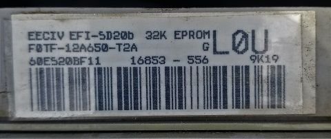

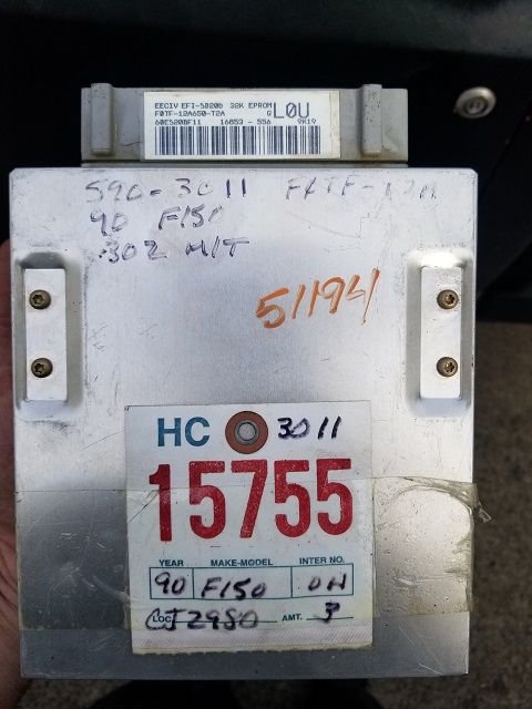

I got the computer opened it, and got the numbers off of it.
Here's the proof of suspected JY/salvage PCM.
Here is the number for the PCM thats in it. I did call Ford parts, and asked about what the number should be, and he had a hard time finding anything, but he finally came up with what he called "the final engineering number" which is FTOF-12A650-TAMR. Does that mean this is the wrong PCM?

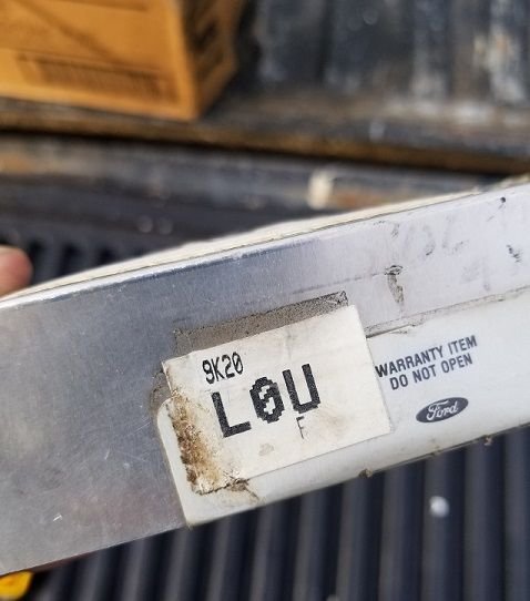

I took this picture, because it says 9K19 on the label in the picture above, but this one says 9K20?
Here is the picture of inside.

Originally Posted by 1990dw
I got the computer opened it, and got the codes off of it.
-T2A is for a 90, 5.0L, 5sp... So I would say you have a correct EECM. Now, whether it is working properly is another story..
Update; 85lebaront2, lookrd up the Catch Code and reports that the Catch Code; "L0U " is listed as F-150, 5.0L and is SD-Bank / Manual Transmission.
I believe this is further confirmation that you have the correct EECM installed.
