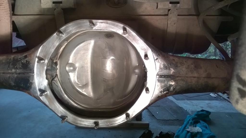

My 85 has a 9" in it and I took it apart, cleaned the housing, inspected the gears and bearings, installed new bearings and seals, brakes, wheel cylinders, and drums. I thought about swapping it out with the 88 but was not clear on exactly what it would entail. It too had a vibration.
I did that work with the axle under the van. I used a broom handle and rage soaked in brake clean to clean the tubes and did the rest by hand. I had my son to help back then. I used a floor jack to lower the third member as that thing would be almost impossible for one person to remove and install by themselves, under the van, me anyway!
