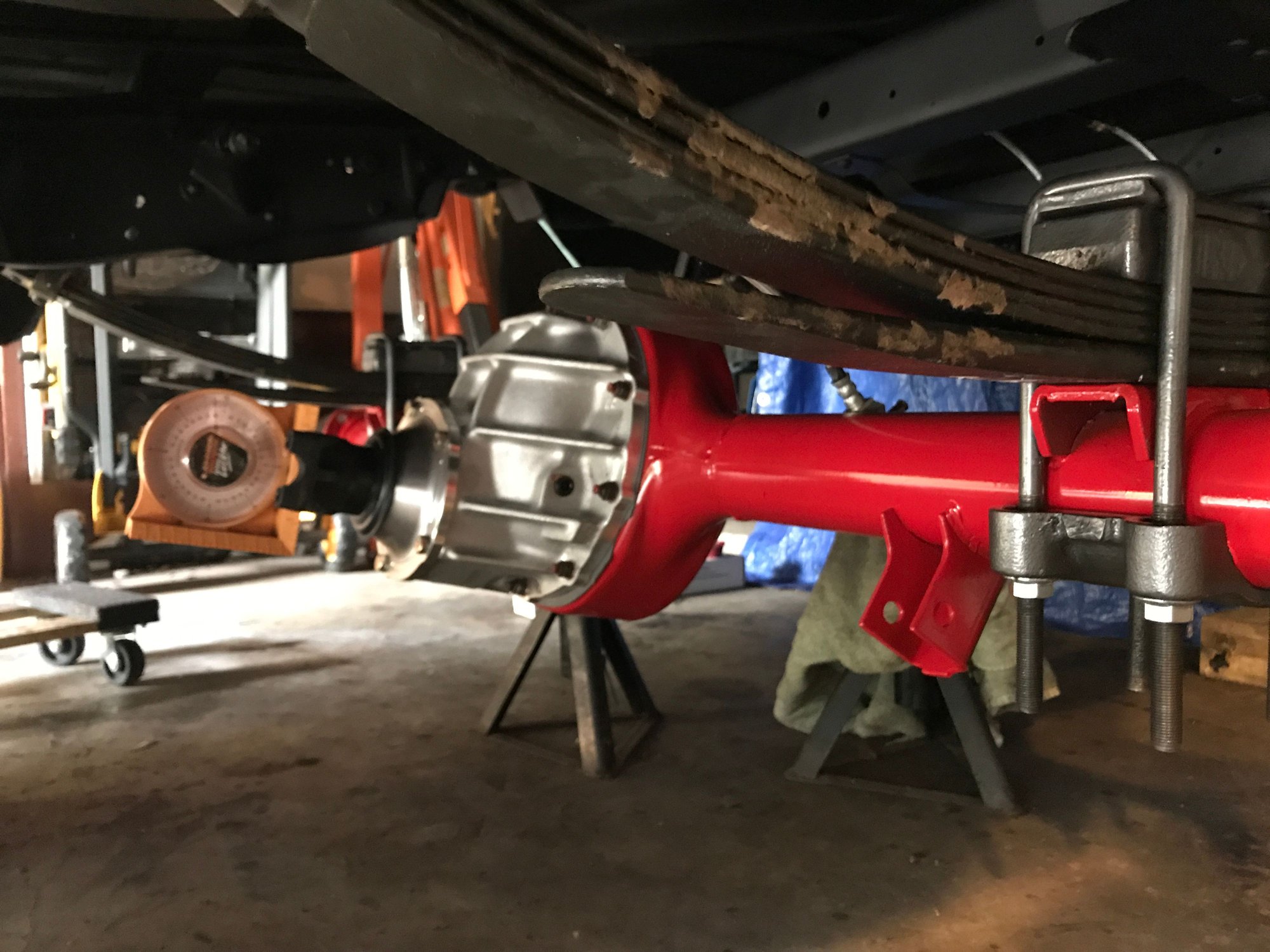

I did the same thing, basically, as Unimoe. I bought all new springs but factory spec. Used DJM front and back. I did need a 4 degree shim to correct the driveshaft angle. My rims are equal width so the rear have additional offset. F=20x9 with 3.5 backspacing. R=20x9 with 6.0 backspacing. Tires are 245/40/20.
Old Apr 8, 2018 | 08:18 AM
xanthias's Avatar
xanthias
Joined: Feb 2003
Posts: 335
From: Houston, TX
Suspension detail. The rear axle shot is before I added the shim. I failed to mention in prior reply I had to notch the frame. Sorry if confusing - these pics were taken at various stages of work with mock-up, old & new parts, etc.
