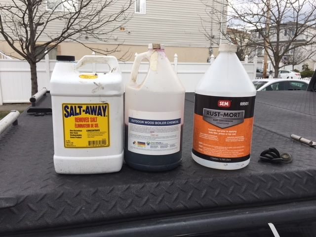

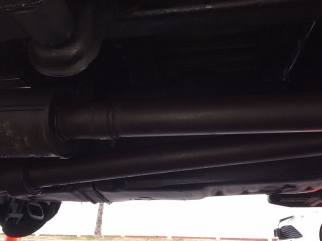

so far, keeping the rust monster at bay.
strategy is
1. salt away
2. rust mort
3. rust inhibitor
4. used motor oil
I use a fluid film spray system mainly because it can handle thin and thick fluids
pressure washer
gas air compressor (the electric ones bleed out quickly...the gas one never bleeds out and maintings 100psi)
4 6000lb bottle/jack stands
I pressure wash both sides of the rims, then coat the inside with penetrate spray....seems it make it easier to clean.
probally a 4 hour drill.
some pictures

Looking good, but you will eventually lose that battle. Still, you are probably years ahead of the herd and that will save a lot of $$$ compared to vehicle replacement.

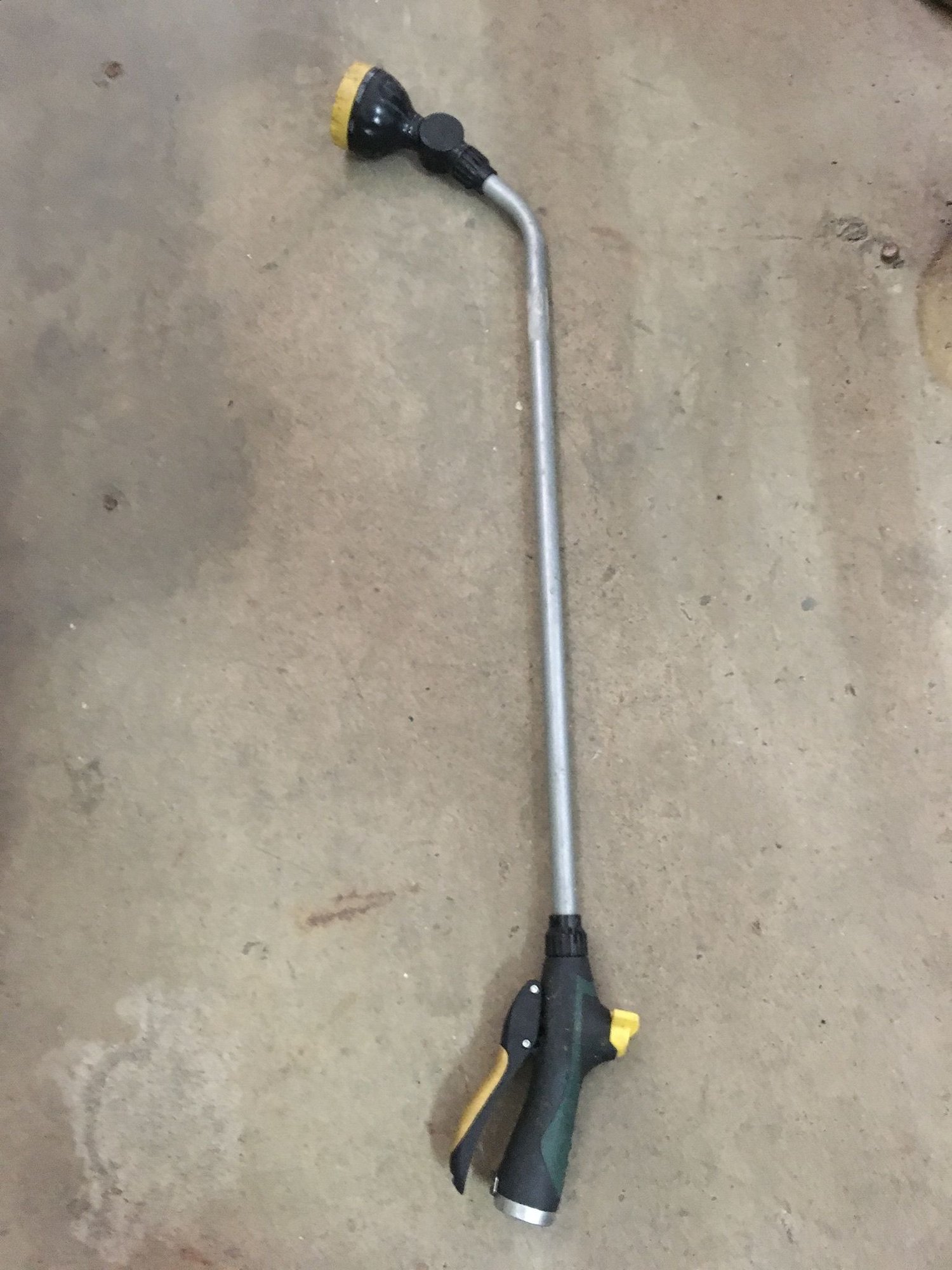

Looks good. Did you make those flexible wands for the fluid film sprayer, those looks like they would make my bi annual spray down go a lot quicker.
the fluid film folks sell the straight aliuminun and the flexible PCV ones
