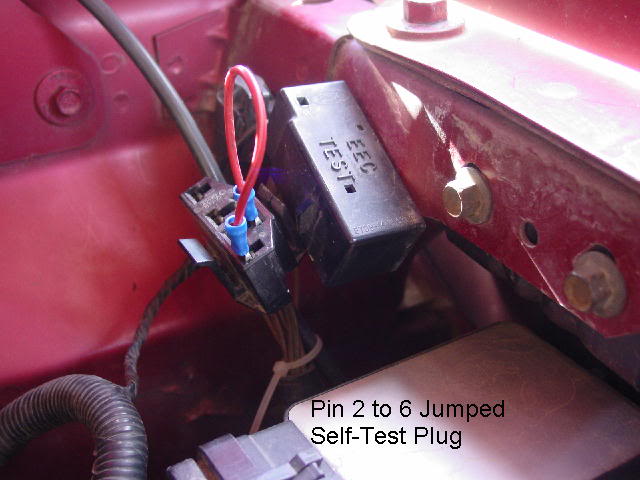

I got this '94 7.5l with a KOEO 542 code.
Truck cranks but won't start. Fuel pump doest activate when key is turned on. I checked relay, inertia switch and tank selector and they all seem to have power.
Where do I go from here?

Short pin #2 to pin #6 and see if the selected pump runs with the key is in the run position.
Attachment 280124
Attachment 277922

Jumped 2-6 with key on. No power to pump. Probably bad pump

Dose the PCM Power relay click each time the key is turned on?
Then if it does click while doing post #2 above does the fuel pump relay click each time pin #2 is shored to pin #6 with the key on?
If no does the fuel pump relay click each time pin #6 is ground to the engine with the key on?

Relay clicks when pin #6 is ground to engine and when jumped to pin #2
