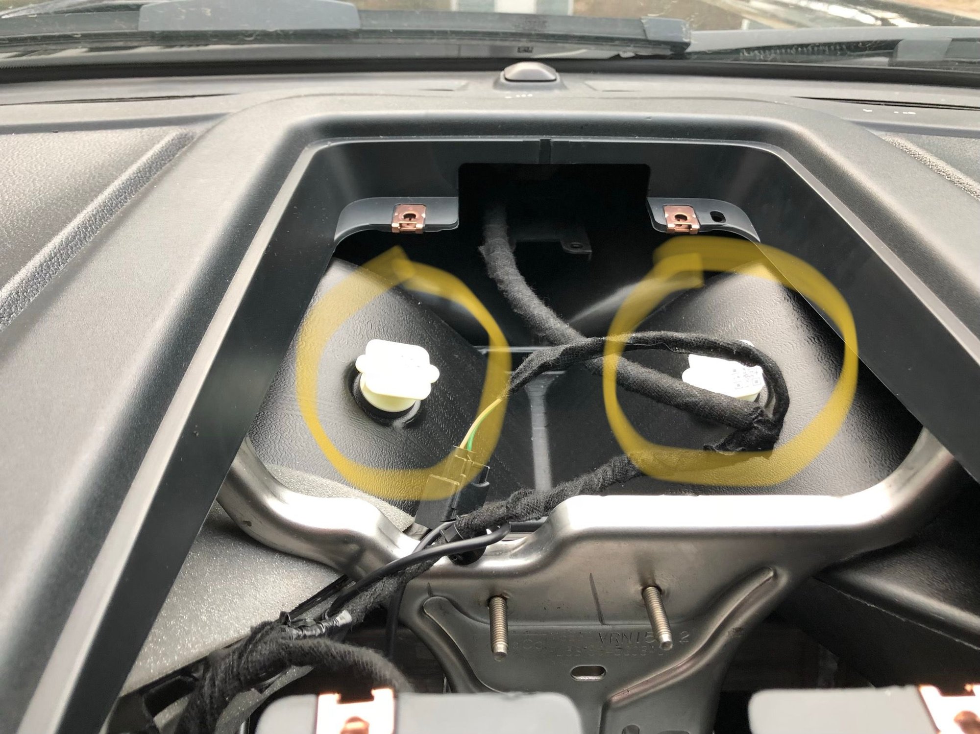

Thx again for the video. I definitely used it. Anyone happen to know what any of these connections are for?

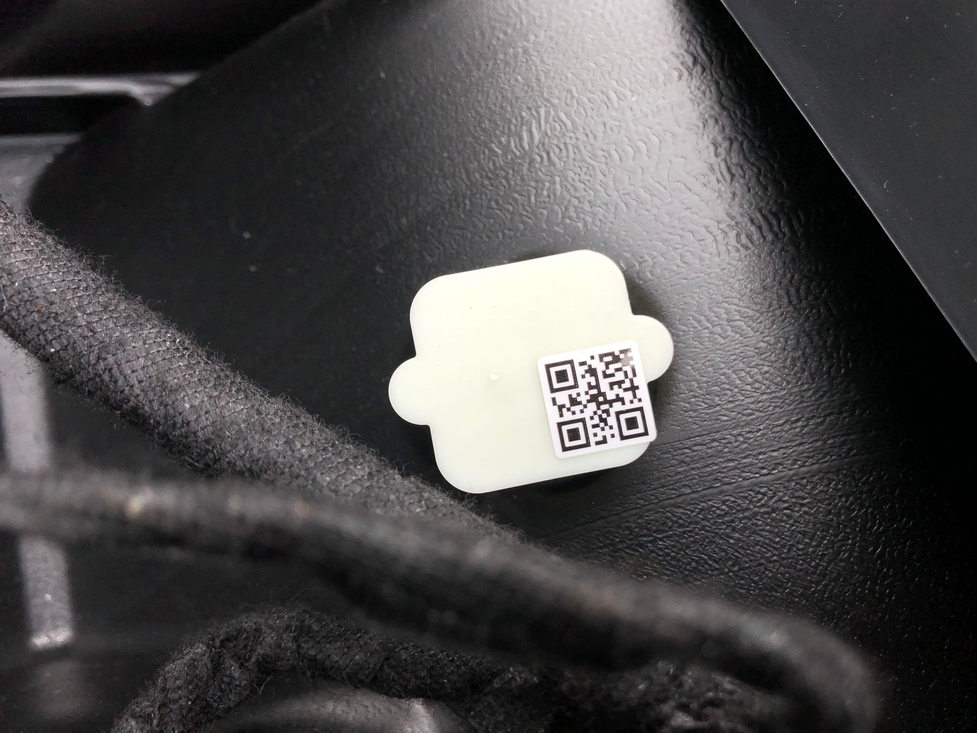

From: Western MA
This one is on the back of the sync screen itself
