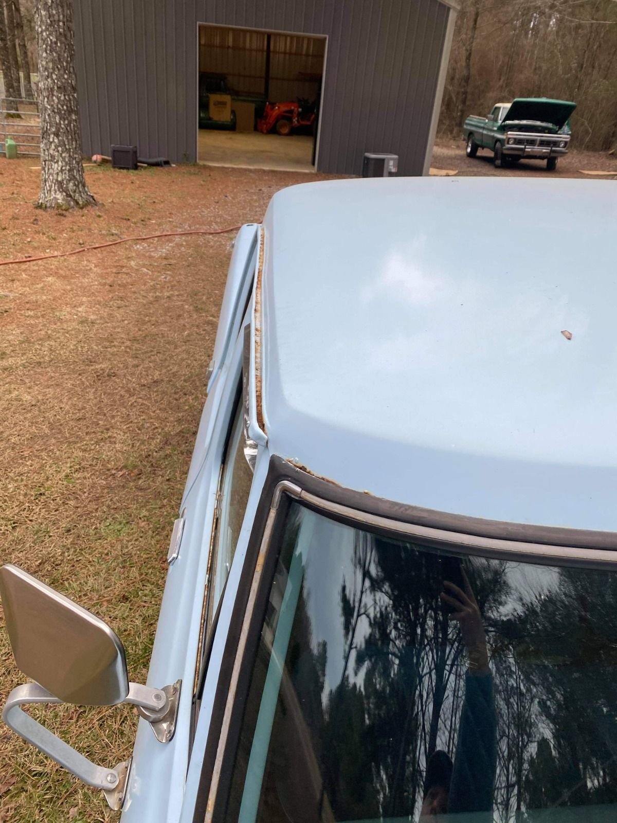

I ordered Precision Replacement Parts seals five years ago when I repainted my truck. In less than four months, the "chrome" peeled off. Also, the window seals are already crispy and dry rotted. Would not recommend PRP.

As usual most of the reproduction parts are crap. but it is what it is. keep it under cover and it lasts a it longer.
All you need is the lockstrip and the right tool. I use a Liesle brand tool and window cleaner to lubricate it and I've done lots of windows. the older the gasket is the harder it is but as long as they aren't rock solid you can do it.
