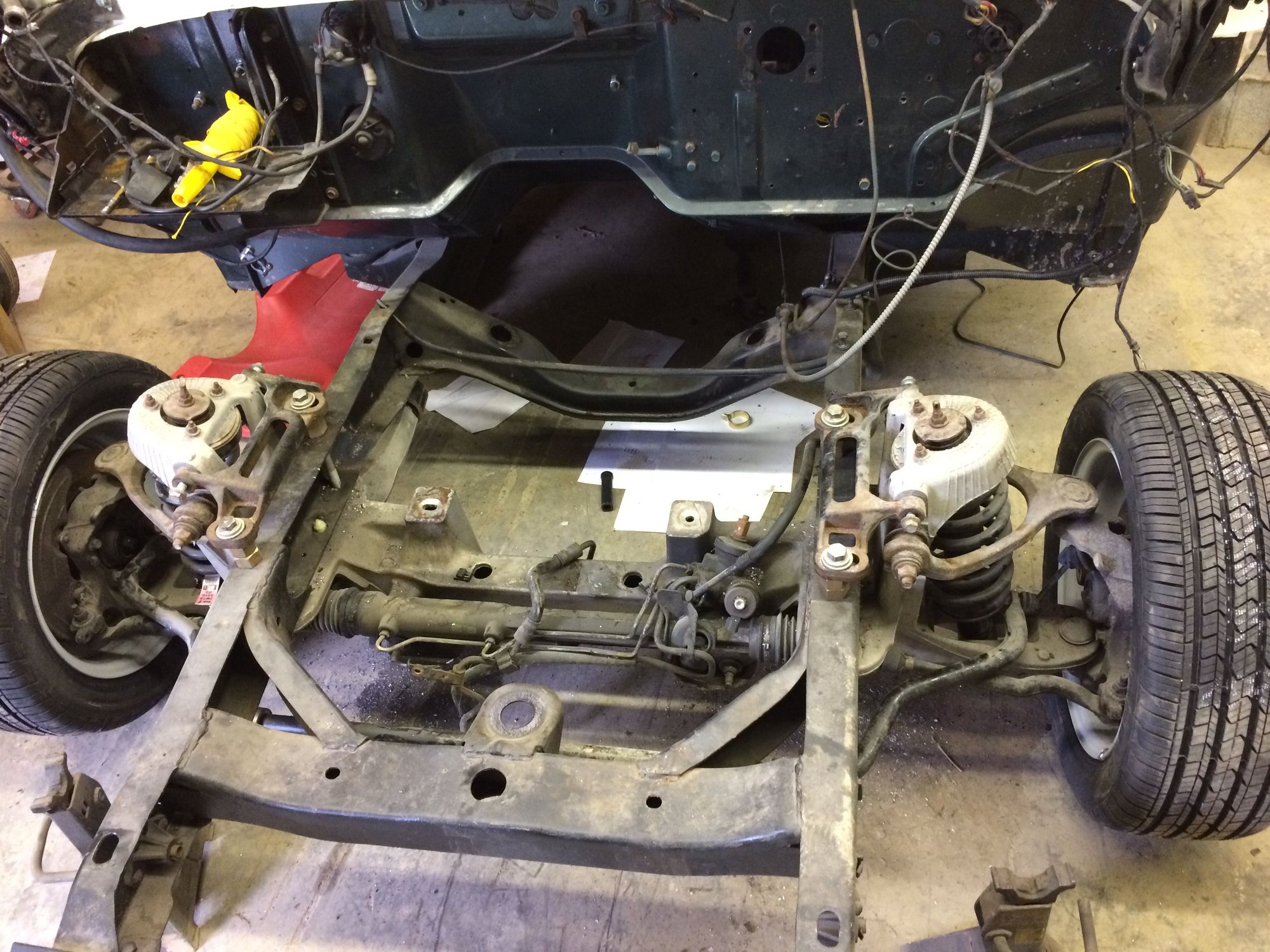

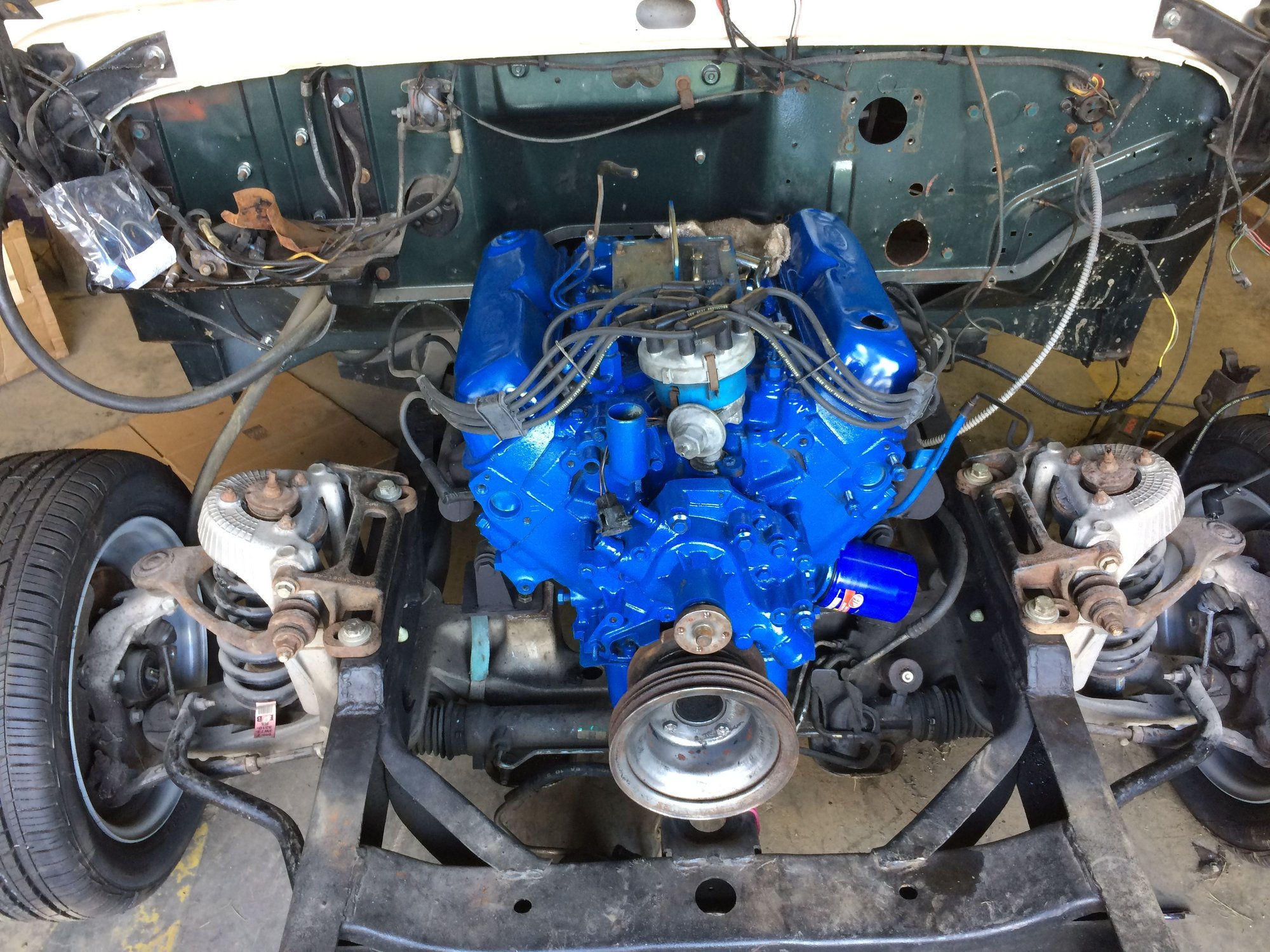

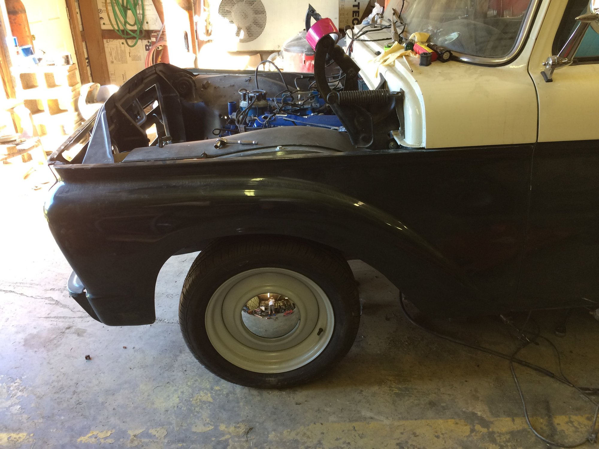

I am working on the CV swap in my 61 Unibody and I moved the centerline forward .75 as well. My opinion concerning the 65 and 66 trucks would be to consider the .75 carefully. Measure twice and cut once. The CV is a 16" wheel where the old I-beam sits on 15" wheels. The difference in wheel size may give you reason to move the centerline a little, but maybe not a full .75.
Fits pretty well, moved centerline forward .75
Front clip fit, inner fenders needs some trimming
Trial fit, 351w
