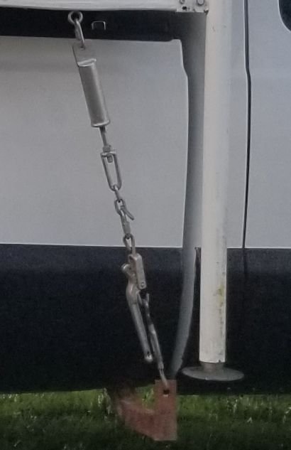

tie down was rusty because i hadnt yet POR 15 them this winter when i picked up the camper.
They are pretty proud of thier parts for sure. I have some friends that were able to fab some frame tie downs for me, cost a total of $300 but they worked perfectly. The used camper i bought came with some old funky spring loaded cans and chain with a swivel handle connect disconnect, but i think I'll spend the $130 and get some stainless turnbuckles that are spring loaded up front and dampered in the rear..I will show the finished tie downs and mounts later . But these spring loaded fastners are bizzare , cant find anything like them . the rears were not spring loaded and it damaged one side from too much stress .I had to pull the aluminium off the side and repair that one.
