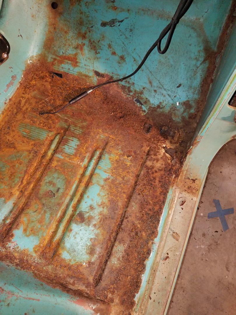

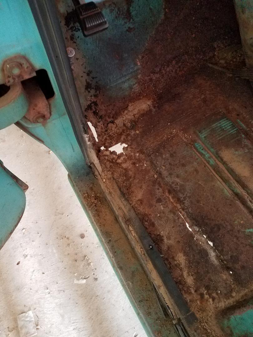

Hi guys,
My 13 yr old son is the proud owner of a 67 F100 SWB. We just got it a few weeks ago. I knew it had some rust in the floor pans, and pretty clean everywhere else. The plan is pretty simple, CV front end, explorer rear (I think) , coyote, blah blah.... Pretty basic for these now a days. In looking at the pans, there are some spots. Not quite a flinstone mobile, but if you have small feet, we may call it one. WIth that being said, any reason not to replace the whole things, and mot patch it. Pics attached.

Cab mounts are under there, might as well replace those also as they will be rusted. I did a 72 once that was nowhere near that bad and had to replace about 6 inches up the kick panel to get solid metal, and it didn't even have a bubble in the paint. I guess I'm just saying, plan on going a lot further than you think.

Thanks. The cab mounts dont look bad, but I have yet to take it off the frame. I am getting it blasted before starting on the pans, so that will shed light on all of that. I suppose it makes sense to replace all while I am there. Trying to get the bed and cab off the frame, then off for media blasting in the next few weeks. I am still in the process of stripping the firewall and gauges, etc. Getting the darn dash pad off about killed my hands. Ultimately, this is a project to get my son off the computer while spending time with him and learning new things.

For what it is worth, had floor pans about like that in my 71. I ended up, ospho (ing) and painting the rusted areas, then took new pans, fitted them over the old and used rivets to secure (about every couple of inches across edge and some to pull it snug on the floor. Then I sealed up the edges with seam sealer and sealed up underneath as well.

A lot of the areas that rust, like the cab mounts drip rails and kick panels, rust from the inside out because they are raw metal on the inside. Take an ice pick and poke around. If you see any bubbles at all in the paint, the metal behind it is gone.
I have also owned trucks with roadsign repairs to the floors,lol. I think people worry too much about floors. I use 18 gauge, my $99 HF bead roller and make my own. Once they are in and undercoated good, who is ever going to see them?
