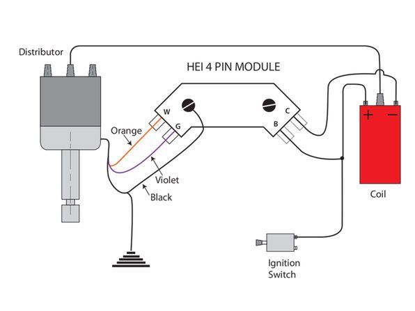

Here are a couple of pics of my install. The ECU is inside the cab, No moisture, No heat and it is out of sight. Under the hood other than that Duraspark plug it appears stock.
I used the FBO box on this truck because it was made in the USA, came with a new coil with a built in resistor, has a good warranty and it has a built in rev limiter which I felt I needed on this Cleveland to keep it in one piece. But if you are looking for the cheapest way possible you can put together a good daily driver system with off the shelf parts. Here are a couple of parts numbers from Summit, the ECU is SUM-850018, the harness SUM-851010, you will also need a 40kv coil for an electronic ignition an a 1.25 ohm resistor. The Summit box comes with a wiring diagram.
The diagram is how performance distributors wired theirs.

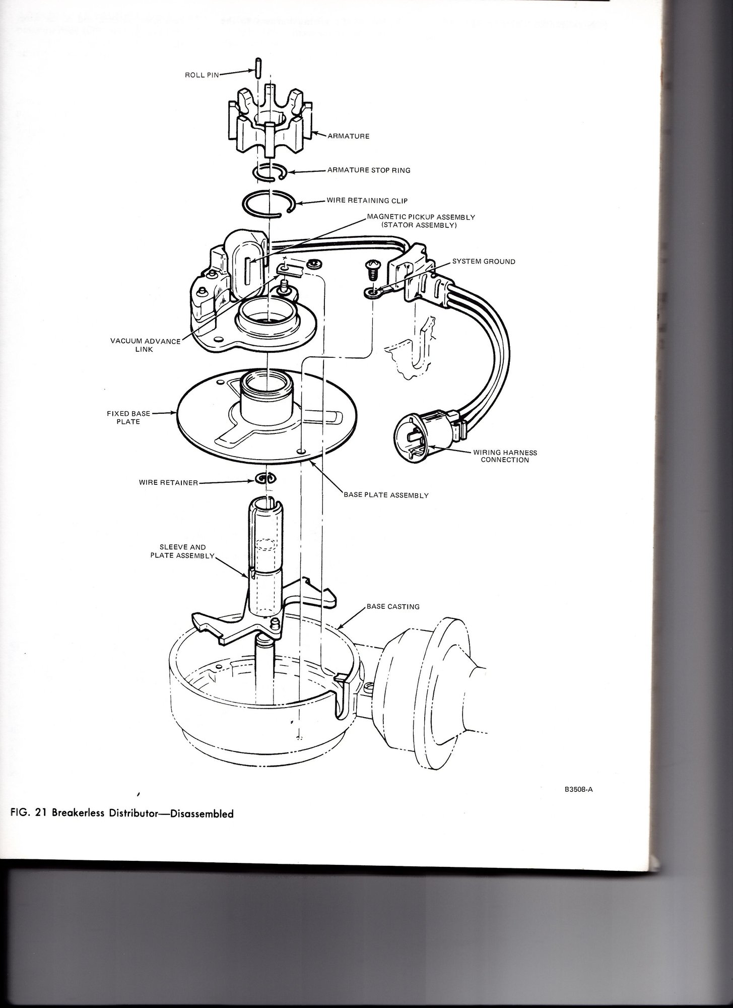

In order to convert a points distributor to a magnetic pickup you would have to change all the parts shown from the housing up. It might be possible, I've never tried it.
At the very least you would have to modify the housing for the harness to pass through. I think you only have two real choices. Find a 1974 to 1976 F100 or F150 that has an FE with a Duraspark at the junk yard. Or the best choice for the money you want to spend is to get a new one from a local parts house and check the gear location and end play before you install it. Keep in mind that the sleeve and plate assy. is part of the centrifugal advance so you will have to set the advance curve.

Very possible, I've done it many times. There is 1 modification though. In the diagram shown above, there is a "U" slot for the wire strain relief to exit the distributor, on a points distributor, it is a hole(single wire exit). All you have to do is saw down to the hole to create the "U" and you are good to go, it is amazing, but it works out perfectly.

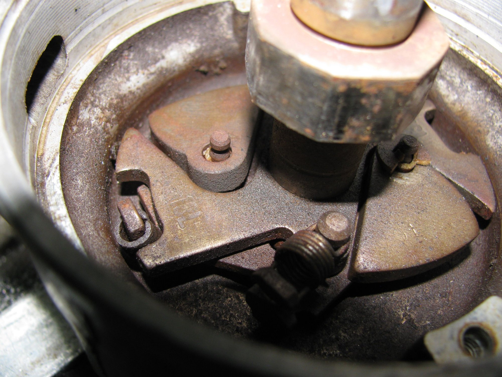

I agree any used distributor you get needs to be looked at closely. Keep in mind that any junk yard distributor you get for an FE will be over 40 years old. Unfortunately no body ever looks inside one they just run them until they won't go anymore. This is a picture of the centrifugal advance out of a 351C that I tore down last week. This is a Motorcraft distributor that used nylon bushings on the advance weights. As you can see the retainer clip is missing on one weight and the pivot pin on the other one was loose in the plate. And both bushings are toast. No way this could have worked like it was supposed to.
