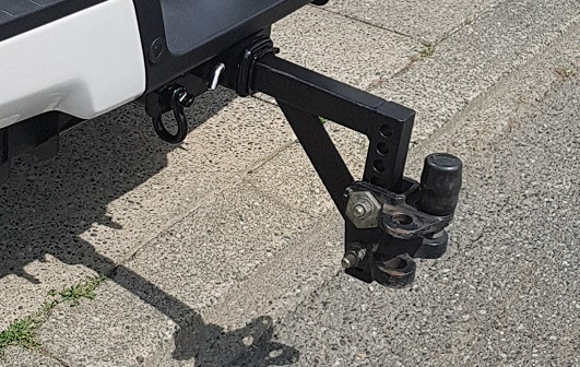

I purchased this Curt shank and mounted my Reese WD hitch on it. I wanted the extension so I can open the tailgate and not worry about hitting the tongue jack on either of my trailers. Works great, keeps the option for using the bars if towing heavy and didn't break the bank.
Attachment 280849
