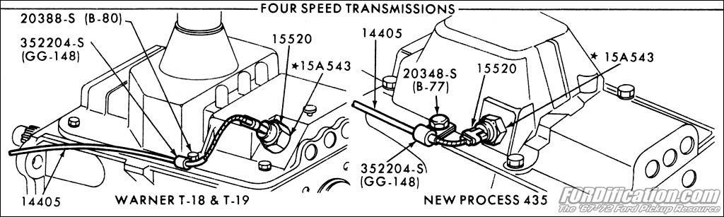

While this is for a 4 speed, your's will be nearly the same

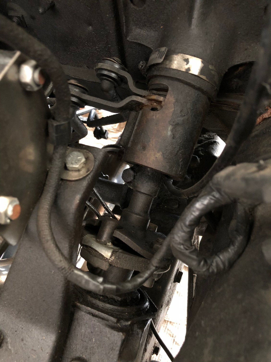

Rag joint, don’t see anything.

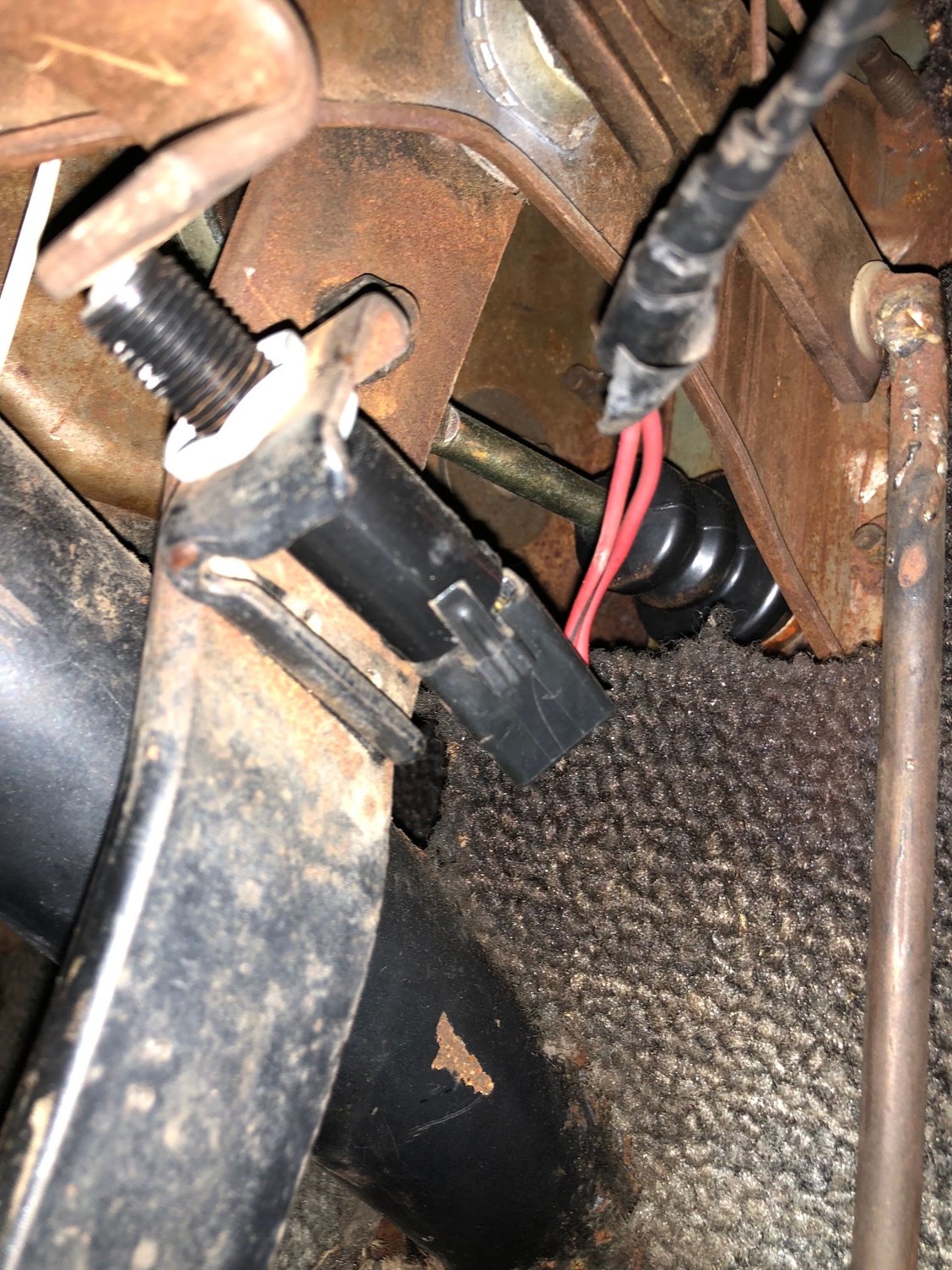

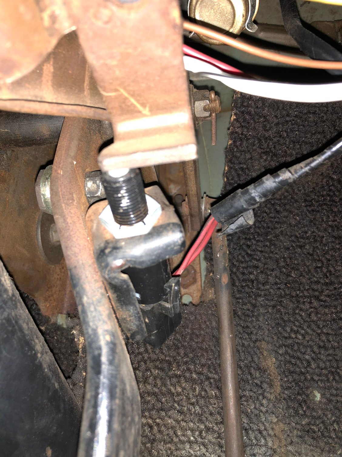

Anyone got a picture of it mounted? Looked all over, can find an image of the part, just not of it mounted. And looking all over for something that looks like that on the truck.
Bulbs are good.

Old Feb 24, 2018 | 02:17 PM
BadMoFo's Avatar
BadMoFo
Joined: Feb 2018
Posts: 57
^ that’s in the cab on the brake pedal.
Old Feb 24, 2018 | 02:21 PM
Brian1971f100's Avatar
Brian1971f100
Joined: Mar 2016
Posts: 1,412
From: Barre Mass
That is the brake light switch. Reverse lights will be actuated when the trans is in reverse. You could always rig up a toggle switch and label it reverse.
