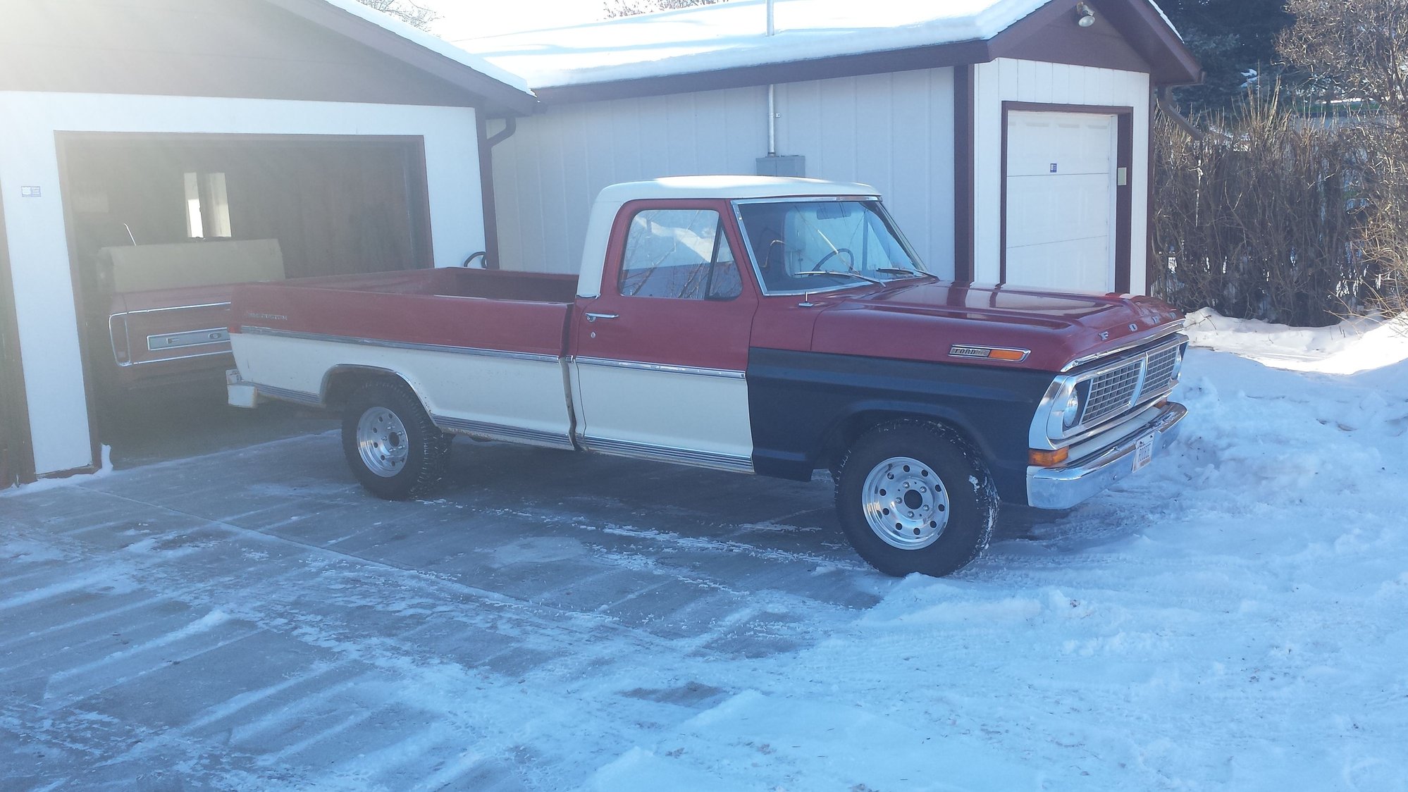

Yes, the factory bullet hole alcoas are a nice cheap upgrade though not as common as they once were. Here's some that were on my dent now on the wife's bump.

Awesome! Thanks guys!
