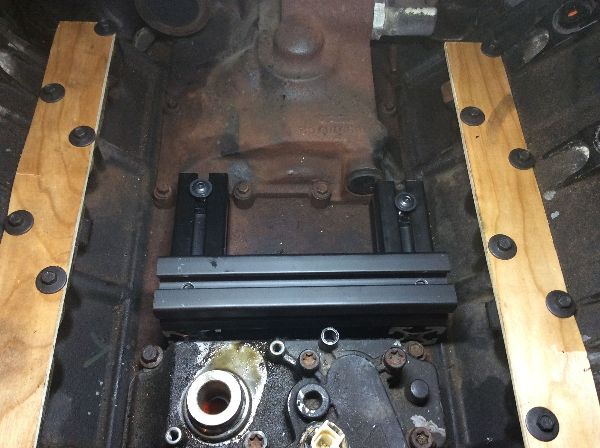

I made this for less than 30.00 including the swivel off ebay. The material was 1/2"x 1 1/2" flat stock out of my local steel suppliers junk bin and a piece of 1/4" flat stock welded to the bottom for rigidity....way overkill, but I wasn't taking a chance with the motor suspended 5' off the ground.
You can use chain but I did not like the way the lifting brackets bent inward against the valve cover so I went this route for install. Worked like a charm

Each pedestal screw hole has the capability of lifting over 1,000 lbs. The right lifting eye and installation is another story. If there’s any angular forces, like from chains going to a hook, severely reduces the lifting ability, basically any side loading.
Someday I might do a pictorial or vid, but it was cheap and easy to build a platform of 8020 extrusions along with a lifting eye to get the motor out, and at the proper angle. Yeah, I know, it’ll freak people out. Ya got to know your metals. And fasteners.

engine pull
This is how I did mine..worked fine

Troy, your blue bracket is one of the example pics I used when making mine, thanks.

I originally pulled it out this way and let's just say I didn't plan on putting it back in that way for that reason alone. The spreader bar worked like a charm eliminating the use of chains and lifting eyes bending
