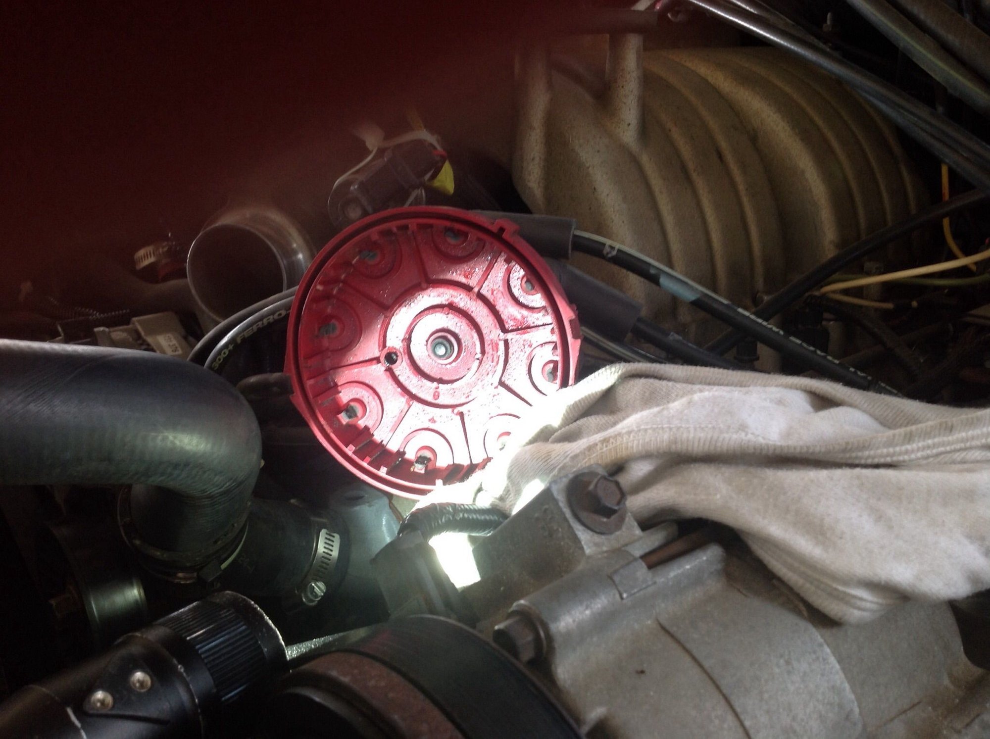

Stumble/hesitation
Thought I would share this picture to save a lot of headaches / heartaches to many members in the future. 1992 351 fi msd6a ignition /msd drop in distributor.After a good rain or humid conditions here in the south,this causes a stumble / hesitation .(Truck does sit a good while at times).No codes just your typical pita to deal with.TR
