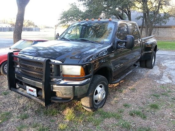

I have a 2000 F-350 XLT SD CC LB DRW. It has a cloth interior with manual seats and electric windows and door locks. For a while now I've been looking to upgrade the interior.
I found an ad on CL for a part-out of a 2004 F-350 that has been wrecked. It has a Lariat interior, to include leather all-around with dual power front seats. I have a few questions:
1) Regarding the power seats. I have an existing wiring harness that runs to the driver's side, under the seat. I can't remember if I have one on the passenger side or not. If not, how difficult would it be to get the harness from the donor truck so I can include it on mine? Some context: prior to my son being born I did electronics as a hobby, so wiring something up shouldn't be difficult for me, but I'd prefer to get the original wiring and run it in my F-350 if possible.
2) Where do these wiring looms run to? I presume that there is a body module somewhere that provides power to all of these critters? If so, where is that module?
3) The donor truck has power and heated mirrors. Manual telescoping and folding, of course (I haven't heard of a pre-06 that had power telescoping and folding ... was that even an option or did it not come out until 2006 or later?). So where does the wiring for these mirrors run to? The body module? I presume that the mirror wiring runs from the door switch panel out through to the mirror itself, but where are the connectors? Ergo, is there somewhere inside my dash that I could look to see if I already have the wiring for this running to the door, but just no switches/power mirrors to connect it up to? That would be the ideal situation, don't know if that is what I have though, so I would like to check on it. Basic question is how do I do that?
4) Any other issues that come to mind regarding such an upgrade?
I ask because I haven't ever seen a Lariat interior other than in pictures and I'm not familiar with the differences in wiring harnesses, etc. However I'd really like to upgrade if I can.

No they don't. That triangular hand hole design cracks, routinely, where the five leg aluminum spoke meets the rim. The design was discontinued. Alcoa won't even manufacture replacements. Alcoa actually pulled the replacements from their catalog, and virtually erased all printed evidence of their existence.
I'm guessing that you're referring to the factory wheels, yeah? This is my truck the day after I purchased it:
I presume that these are the triangular hand hole design you were referring to? Have you seen any crack? Have yours cracked? Just curious if there are any stats on approximately how often that occurs. 'Guessing that the probability of failure increases with an increase in age and/or wear.
That said, here are the front and rear wheels on the truck that I'm considering:
Different animals, as you can see, and my plan was/is to exchange mine for these prior to selling the truck on. Are you familiar with these wheels? Know anything about them? I hadn't seen them previously. The fronts seem like those you'd find on a big-rig/semi.
