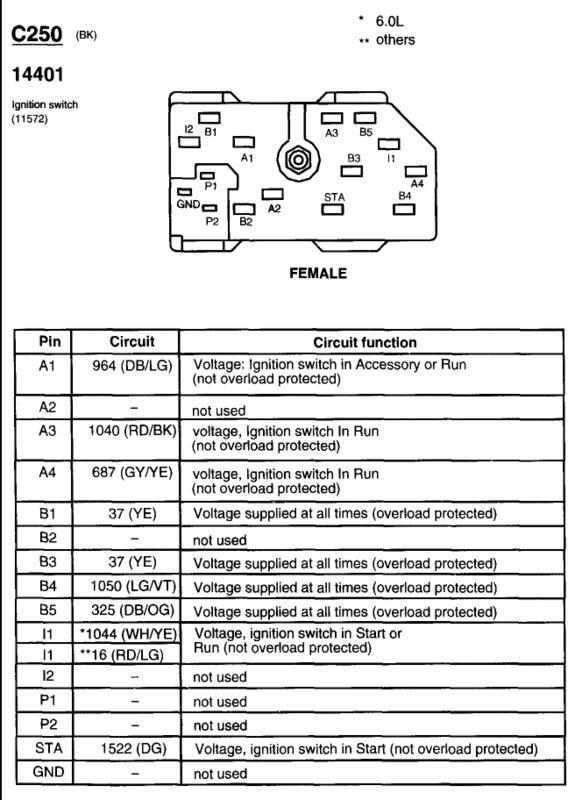

I found this online, anyone know the difference between ignition 1 and 2 and acc 1 and 2?

Can someone just dumb this down for me? When I turn my key to the run position, all the accessories come on. If I want do all that with my own switch, what wires do I need in and out?
Old Feb 11, 2018 | 09:30 AM
MurderMode's Avatar
MurderMode
Joined: May 2012
Posts: 235
From: Decatur
Ok so here’s what I am thinking. When the key is turned to run, A1, A3, A4 and L1 all become powered. So I should just be able to run power to those 4 wires and when I flip the toggle switch they should all come on right? I feel like I’m on the right track here just a few questions I have. This would fire the glow plugs correct? And how many amps do these 4 wires carry? I want to make sure I get a big enough switch. I don’t have an ammeter so I can’t check them.
