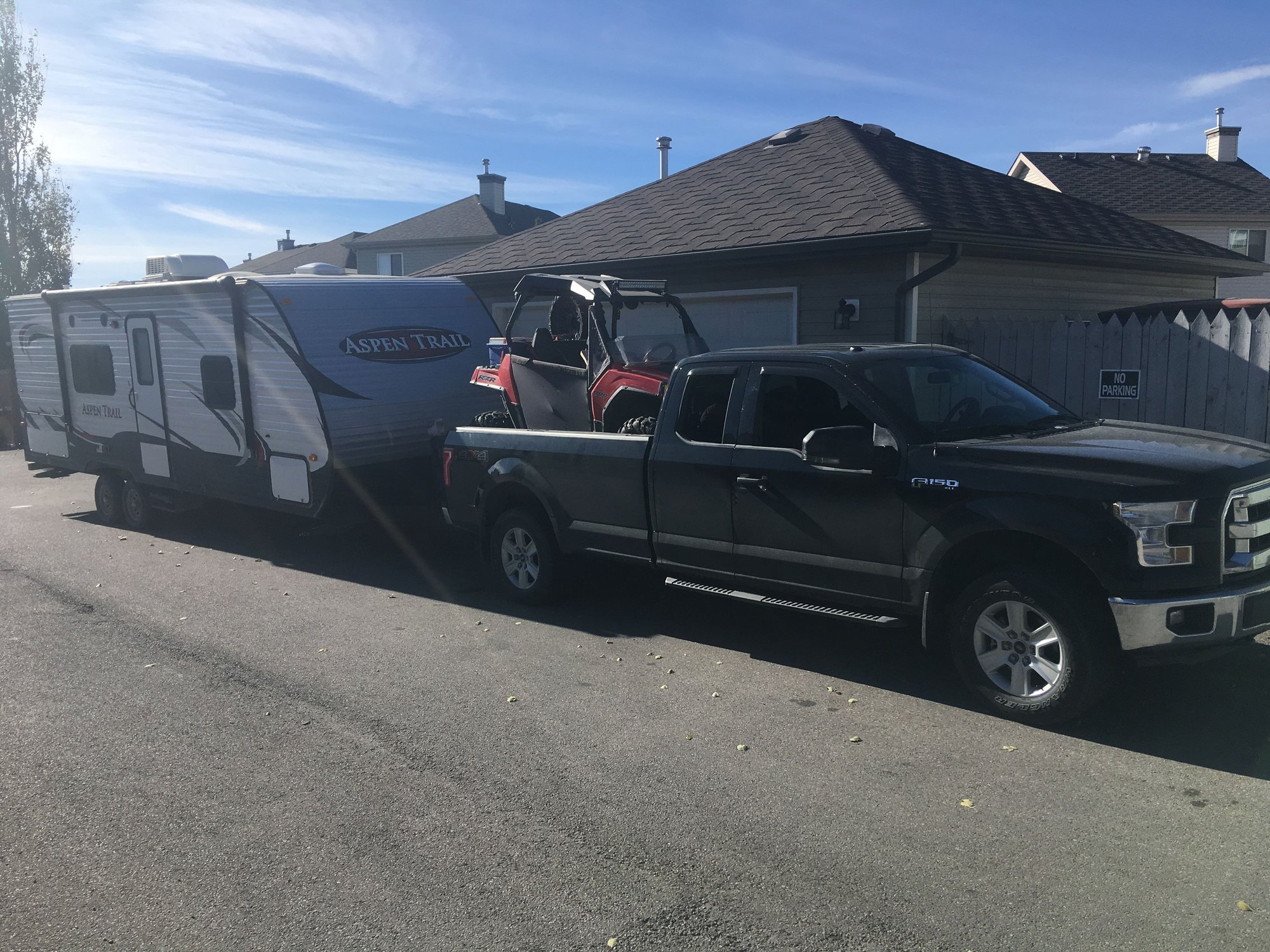

I have a ‘16 HDPP supercab 8’ bed, XLT 301a, 5.0L 3.73, 4x4. Mine rides really nice. Maybe not as good as a non hdpp, but it rides nicer than my wife’s 2013 Sierra 1500 4x4. My last truck was a 2015 F350 CCSB diesel 4x4, so my f150 feels like a car compared to that! I have E rated tires as well, and it still rides nice. At one time, I had installed air bags, but those ruined the ride for sure. I took them out.
As for mileage, Avg is between 14-15L/100km. I’ve seen as good as 8.9. Did a Calgary to Vancouver trip last summer, and I got just under 1100 kms on that tank. 136L tank, but I only filled 120L. Not bad I think!
Towing my travel trailer (4800 dry, 7700 gvw), it uses 19l/100km. My diesel was 21L/100 with the same trailer. I also haul a Polaris RZR 800 trail in the bed a few times a year, along with the trailer, so that’s why I went with the HDPP. Yellow door tag says 2520lbs.
I’ve also had 2 Tundras, a 07, and a 12. My F150 rides nicer than either of those. And I thought the Toyota’s rode nice at the time!
