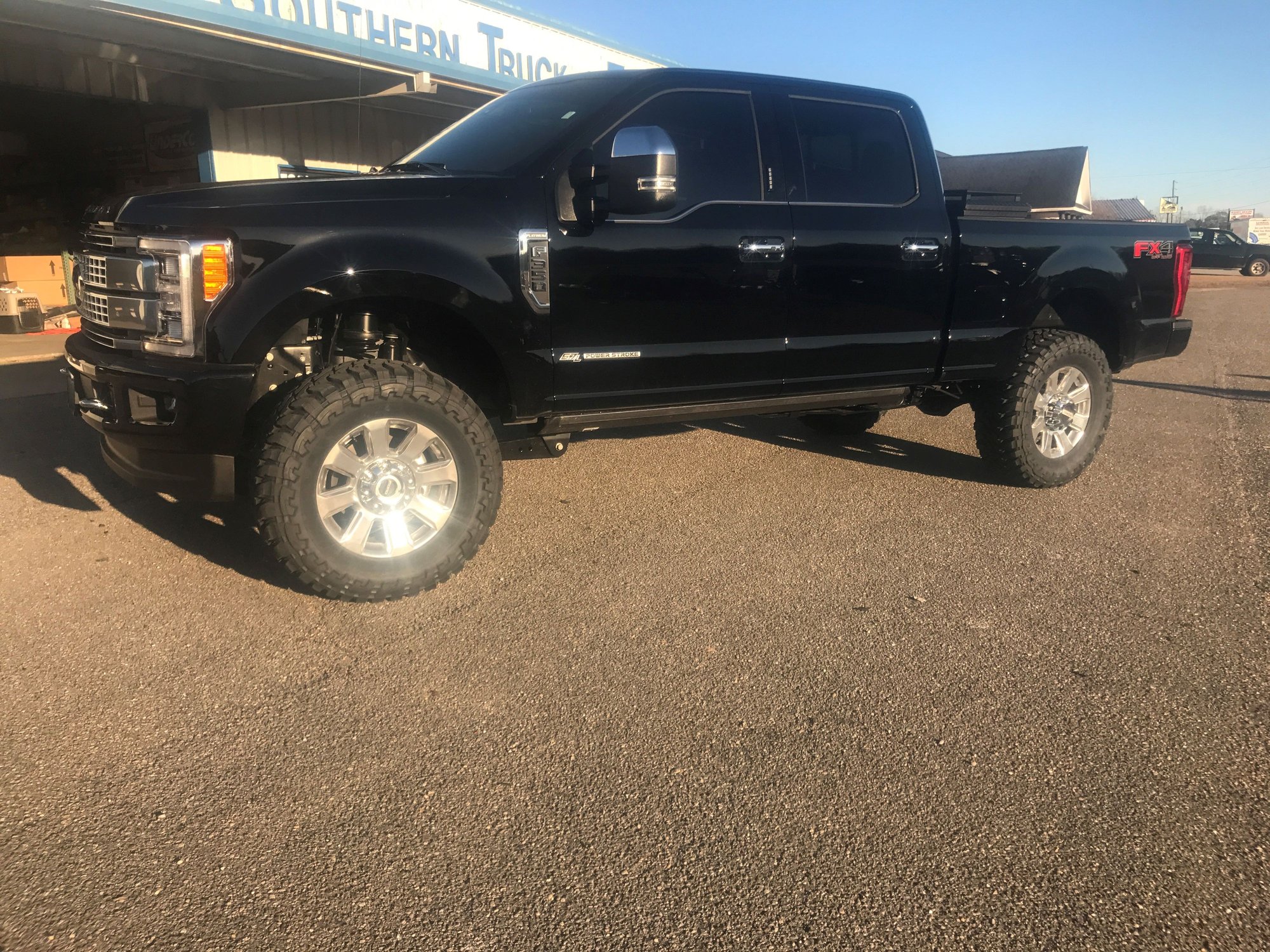

First off , love my new truck so ,far!! had 3.5" readylift installed along with 37" Toyo M/Ts. Is there . I assume I have to go to the dealer to get my tire sensors recalibrated for the bigger tires, don't know how long I can ride with light on and screen saying low tire pressure!!!
