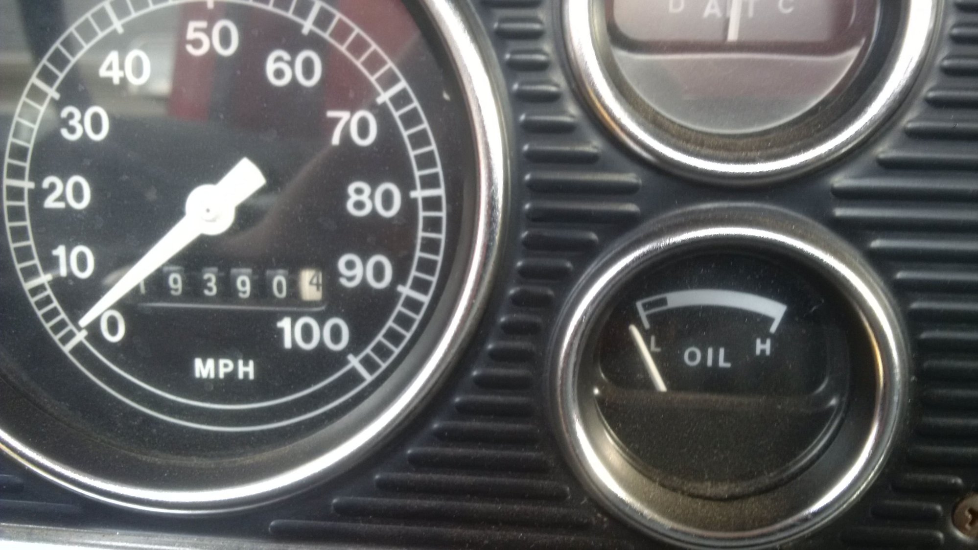

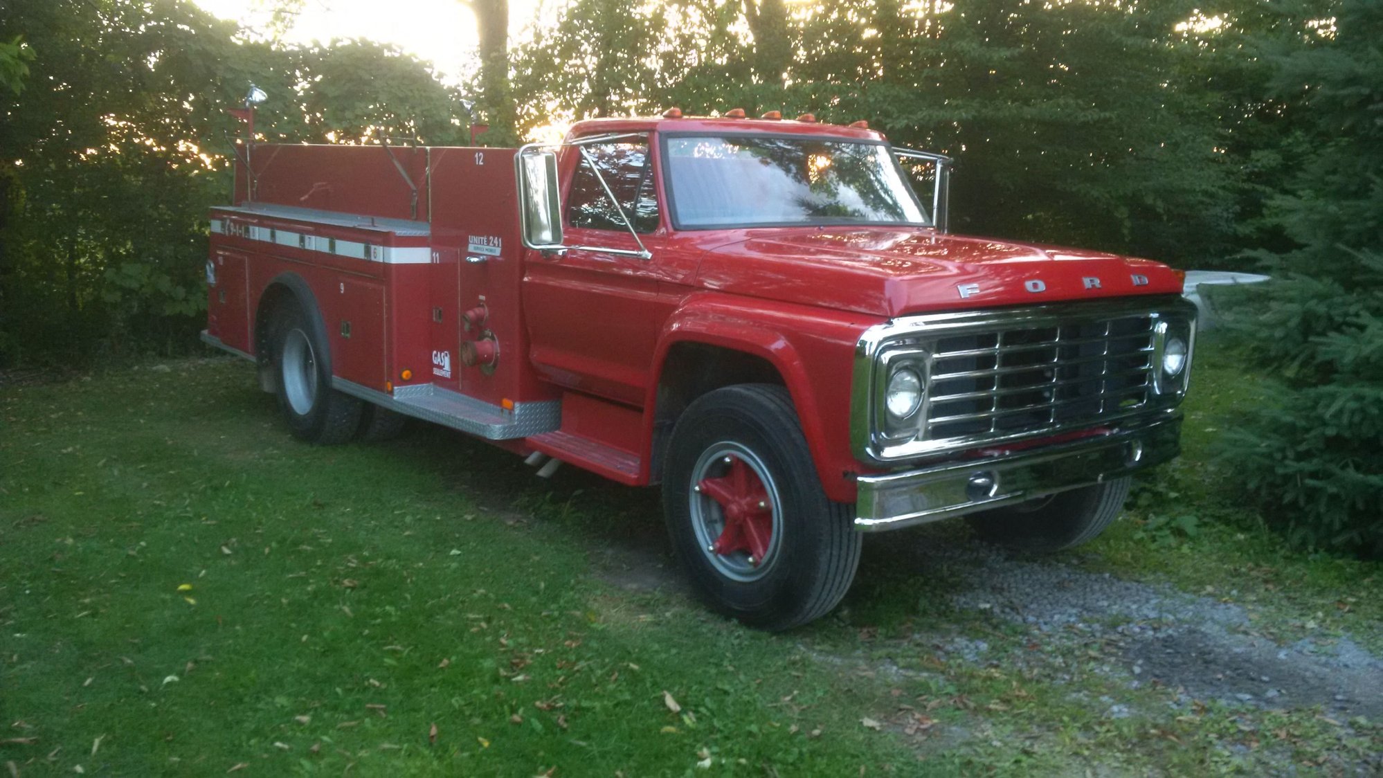

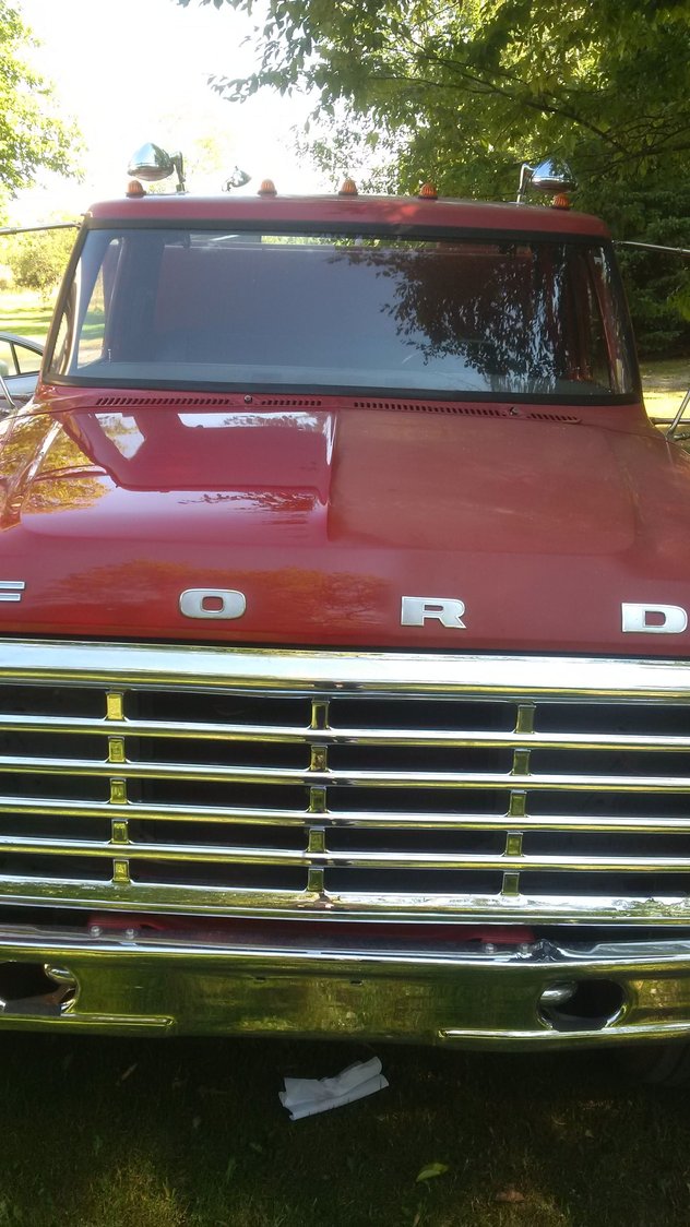

I figured I should start a thread to keep track of the progress on my F700. I purchased the truck in March of 2016 from the second owner.
The original owner was a fire station in Quebec, the second owner purchased the truck from the fire station in 2011 but did not put it on the road. I would assume the truck was in service until 2011. The tires are nearly new all the way around and everything on the truck was functional. I it has always started right up and I haven't touched the carb or battery since I got it.
The day it arrived
19,000 miles on the odo
Dashpad in great shape.

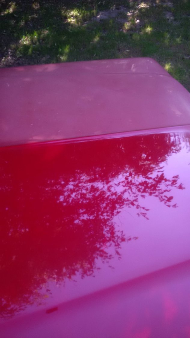

In the year and a half that I have had the truck I have tinkered on it here and there. I buffed up the paint the first summer and was very impressed how the original single stage came back to life!
It has been just over a year since I did the polishing/buffing and it already is looking like it needs done again, so I guess it doesn't last forever.

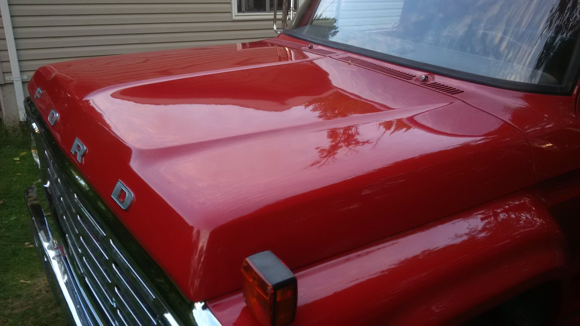

Here it is with the paint restore complete. Pretty neat what you can do with the right tools!

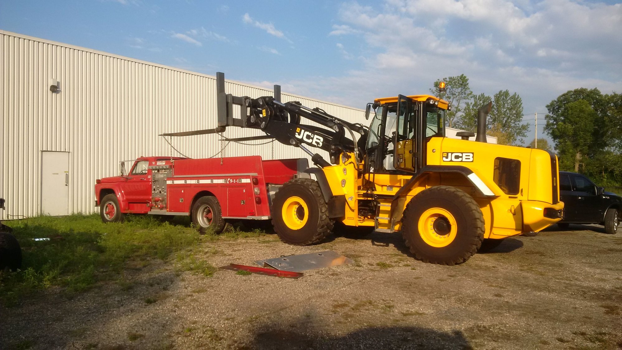

I originally had plans to shorten the wheelbase and put a dentside bed with dually fenders on it. I still think it would cool to do however I have decided to keep it as a longer truck with a flatbed, it will be more useful to have around. I am hoping to get the truck built the way I want it in time to use it this summer.
To do that I need to do the following;
- remove the driveline mounted water pump
- change the ratio - currently has a Rockwell H170 with 7.17 ratio.
- lighten the rear spring pack - gvwr is currently 24,000 lbs. the spring pack is 7" thick and there is no forgiveness
- mount the flatbed that I have. I found a brand new flatbed with trailer hitch and headache rack at an equipment sale for a good price.
I already removed the firetruck body and I should be able to do the rest in time for the summer... we'll see if I can stick at it without allowing my ADD to kick in!
here is the body about to come off...
and off!

Unfortunately the truck received a bump on the front end at some point. It put a ding in the grille and pushed the bumper back on one side. A bit of a shame as the chrome is otherwise in perfect shape. I have an eye out for a straight grille and bumper, which I will have to have chromed, but I know it will be an expensive fix so I am thinking it will get left the way it is for now.

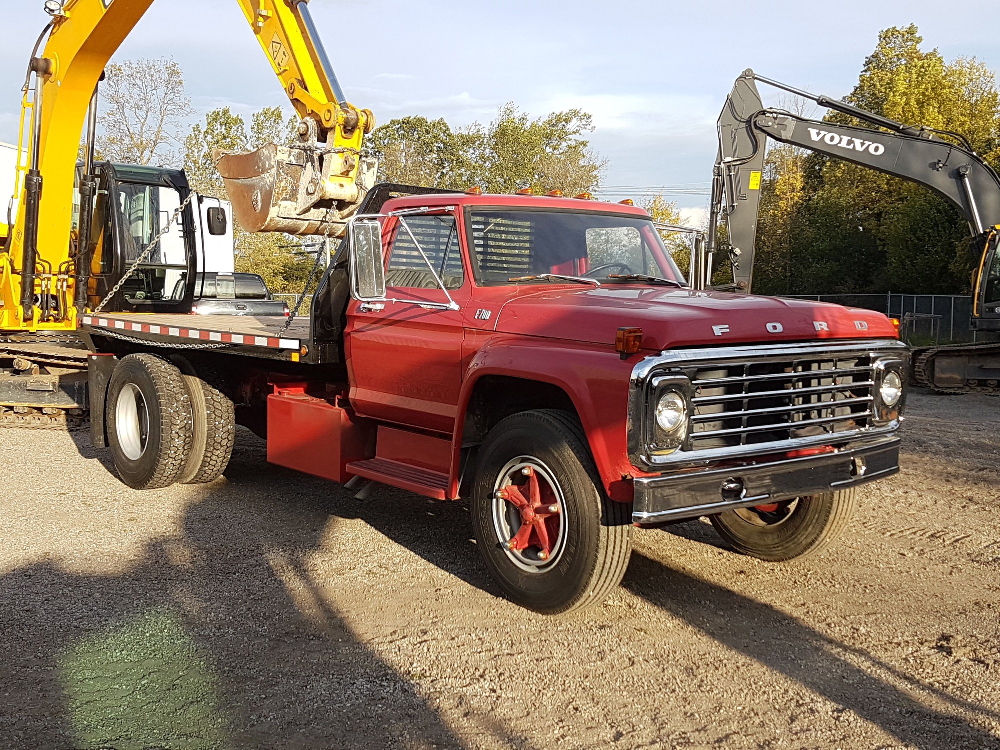

Old Jan 16, 2018 | 07:57 AM
73F700's Avatar
73F700
Joined: Dec 2017
Posts: 296
From: Ontario, Canada
Here's a preview of the truck with the flatbed on it... It is sitting a bit high still as the drive line mounted pump is still in the frame and it protrudes about 8" above the top of the frame rails
