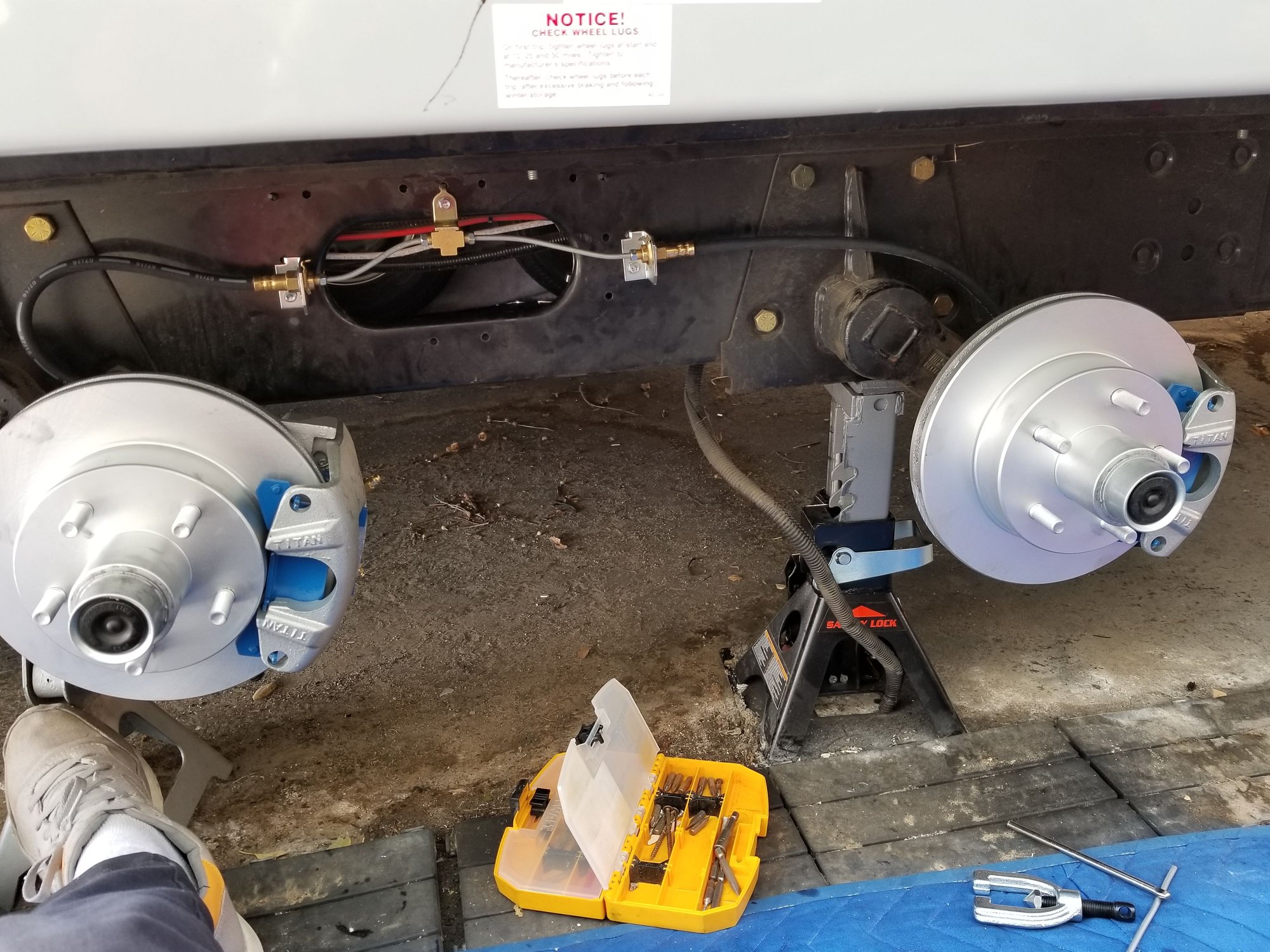

Going to be testing the E/H selection on my IBC soon see if it works better than electric brakes. LH brakes are swapped from electric to disk.

I've never seen Dexter torsion axles with a mounting bracket like that. Fancy.
I'm confident you will like the elec/hyd brakes.

very nice. any way you can protect those fittings from the elements?
Why? That is how they are run on every car & truck I have worked on, just look at your truck.
That trailer unless it will be used in snow/ice/salt will never have the elements on them like a car/truck will.
Now if it was an off road rig then I may want to tuck them inside that opening and only have to hose out so the lines do not get cought on anything kicked up by the wheels and pulled off.
Dave ----
you are much less likely to blow out a tire on your truck than you are your camper.
just sayin' ....

Not too bad price wise. $1300 for the complete kit, I thought about the blow out issue but since one wold also probably also destroy the wheel well and everything above it. Not sure it was worth the effort. Also couldn't figure out how to move every thing inside with out drilling a big hole in the frame behind the rear caliper, and that is where one of my frame joints are. I also just upgraded my tire to Goodyear endurance LRD tires so I have more of a safety margin. Got it finished today except test drive and I didn't feel like taking the cover off just to have to reinstall it again.

It looks very nice.
I would strongly consider putting a plate over the block connected to protect them in the event of a blown out. Everything else is likely to be fine but that "T" is really in harm's way. JMO. Everything else looks spot on.

Ill have to see if I can come up with a sheet metal box to cover the "t" hmm maybe a junction box? Or Ill try to bend one up, I have time nothing planned yet for camping. Although the weather is good enough.

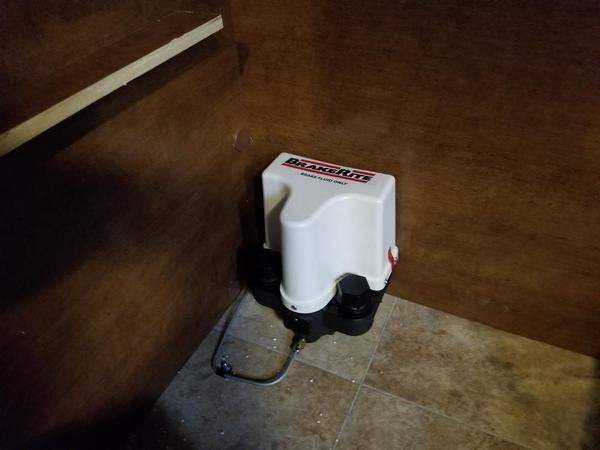

Here is the actuator I installed it under the bed

yeah A simple plate over the hole to block most of the potential damage is what I would do.
That plate can be sacrified in the event of a blow out. Your brake with this type of brakes would be done.
Unlike just electric you may not have any brakes at all.
Even if you were to put it on with liquid nails it would be better than nothing. Not so sure that would hold but you get the idea.

Nice,
Protect the lines....
reason cars/trucks today have duel chambers...
you loose one line..you loose all 4 brakes..
check local metal supplier.. for cut-off diamond plate pieces.. and a few spacers.. as shields.
No rear backing plates... ????? to protect inboard side of brakes..!!
