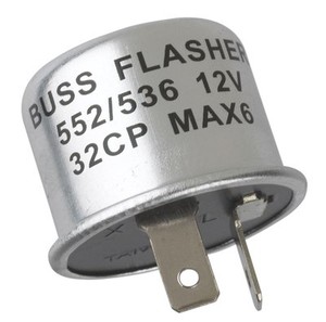

Originally Posted by jtkirbyyyyy
Ok so I just looked at it and it looks like there is a starter relay on the side towards the firewall and one on the side facing the bed. Are those the same relay or is one specifically for one side and vice versa or can I just pick up two of the same relays at the parts store and plug and go with no specific orientation. And I agree with y'all it can get confusing when you're looking at it one way but it's really the other way! Thank y'all again for yalls help!
If you are trying to replace the flashers, they are round plastic or metal and look like this.
Old Jan 5, 2018 | 07:33 AM
jtkirbyyyyy's Avatar
jtkirbyyyyy
Joined: Jan 2018
Posts: 10
Yes sir that's them! So they would be the same for both sides correct?
