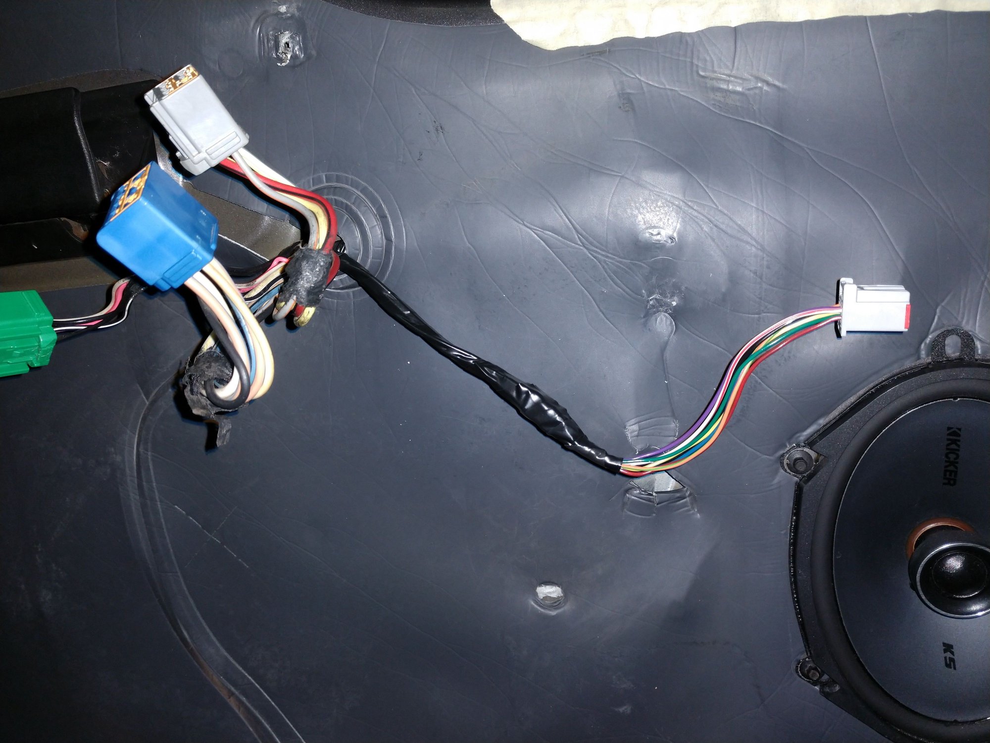

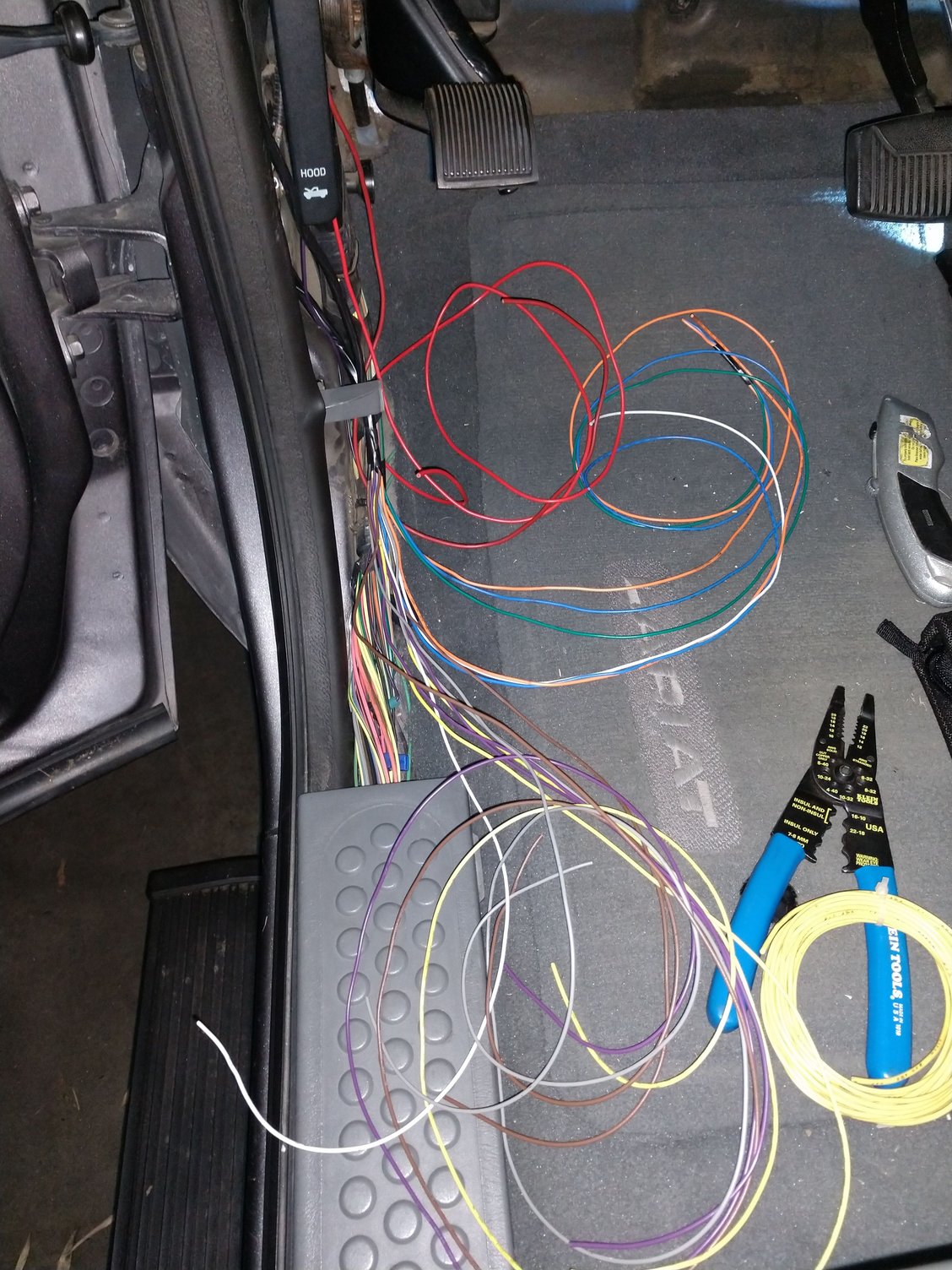

All new wires run but still have factory mirror harness in place...passenger side
New harness wired wired in and mirror connected...passenger side
New harness wired in and mirror connected...driver side
