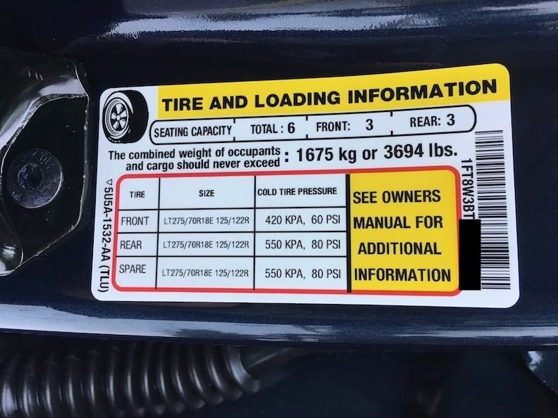

The payload sticker on our truck does not include driver or passengers:
"The combined weight of occupants and cargo should never exceed..."
