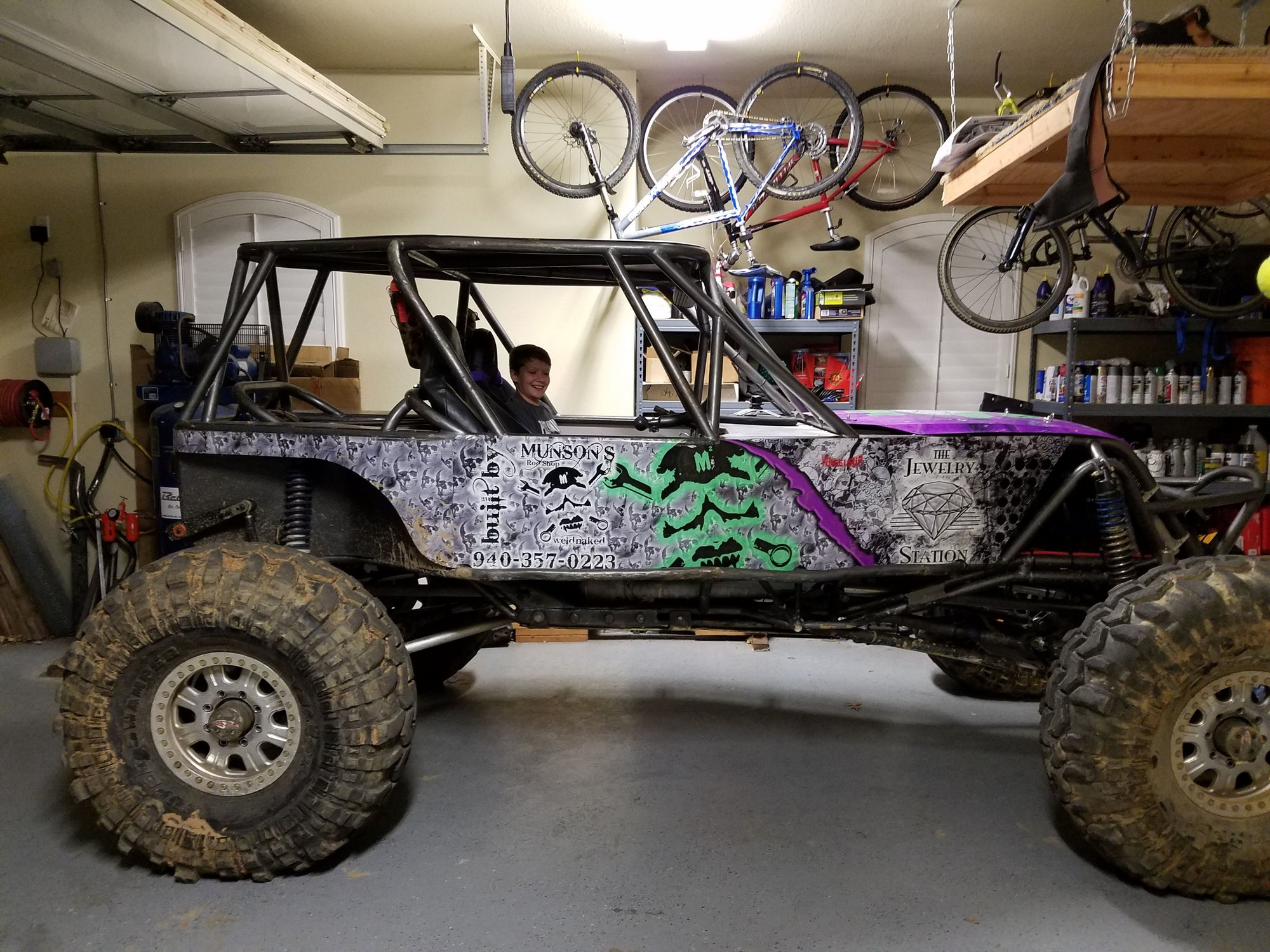

Maybe on a mall-crawler jeep. But, on something as heavy as a SD or on something that is built for serious offroad, this isn't ideal. A true slider is stout enough to support the weight of the entire vehicle without any major deflection. My old jeep was on 38's and my current buggy is on 43's -- both took/take blows to the sliders that would wreak havoc on a pinch seam if it ever came into contact. Big hits to DOM tubing result in permanent bends, not flex. You can see how deformed the slider is on my buggy -- imagine what those hits would do to an aluminum pinch seam if the slider was pushing on it. FYI, the sliders on my buggy were fab'd from 1.5", .120 wall DOM to save weight as it doesn't matter how out of shape they get. If I were going to build a set for a $60K+, 7K lb truck, they'd be at least a 2.5", 3/16" square tube up under the pinch seam with a 2", .120 tube kicked out past the tires. But, I'm hard on my stuff.
