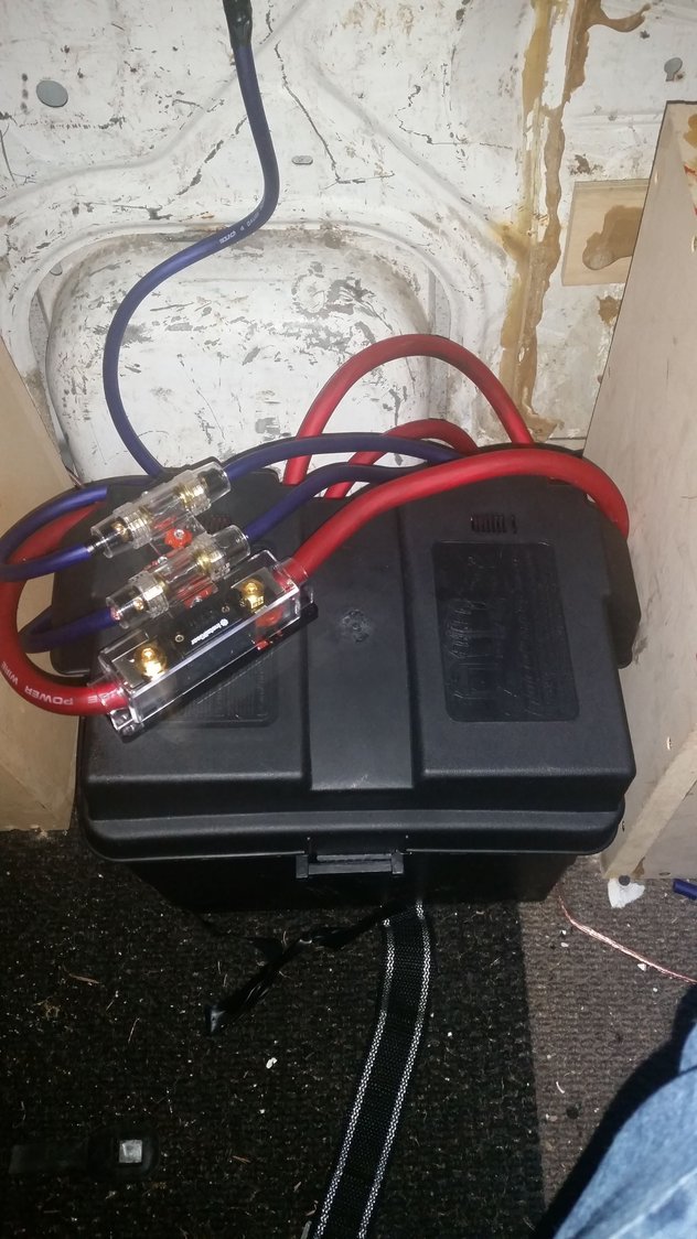

I have 0 gauge wire connecting the 2 batterys. 100 amp fuses on both ends. Is that enough? Did the alternator to batt with 4 gauge. And batt grounds are 4 gauge.

4 gauge is way overkill for the alternator to battery lead.
Grounds need to be equal to the positive leads. They carry the same current.

Wizzy214,,, Where did you acquire those battery terminals?

Those are available on
Amazon Amazon
, among other places. They're not hard to find. Unless you need all those ports, I prefer the
HD military style HD military style
, myself, with properly crimped cable ends.
