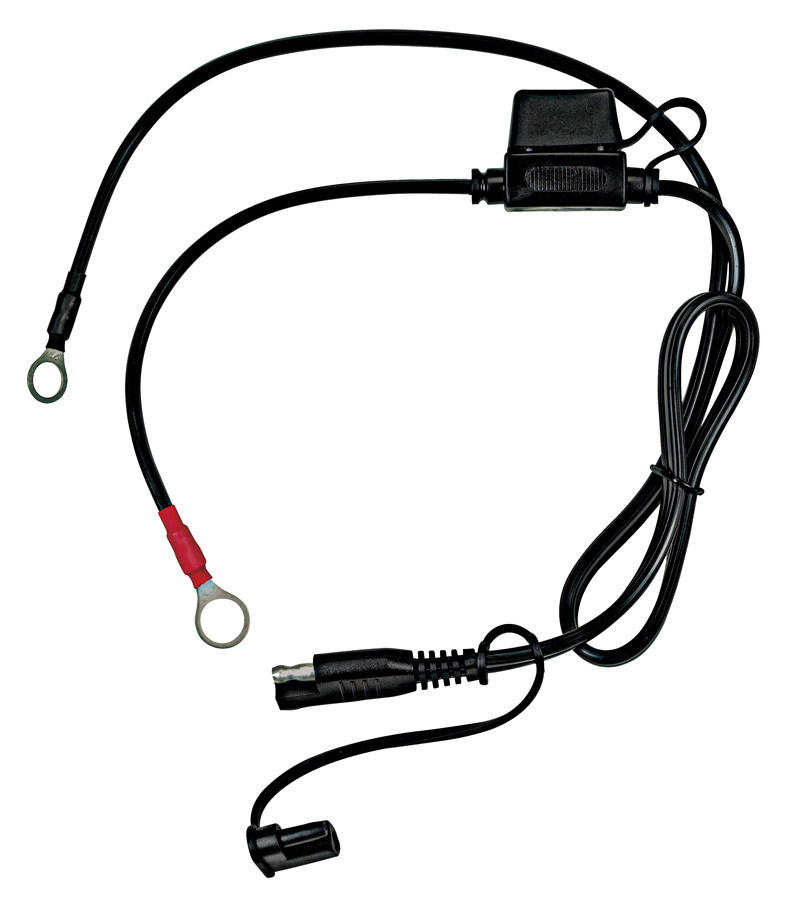

I installed the BatteryMINDer Ring Terminal Assembly on my passenger side battery:
I plug in to the 1.5 Amp Maintenance Charger-Desulfator when not driving. I use these on all my vehicles and small engines. All are outside except the small engine and motorcycle. Been using these for over 10+ years -- No issues.

Joe - thanks. That's pretty much what I was considering, but wasn't sure if running the battery tender cables from the charger was safe or if there was a better way of setting it up.
Exactly what I was going to suggest. I've installed this pigtail on 3 motorcycles and 2 lawn tractors. Makes it easy to circulate a couple of tenders among multiple machines.

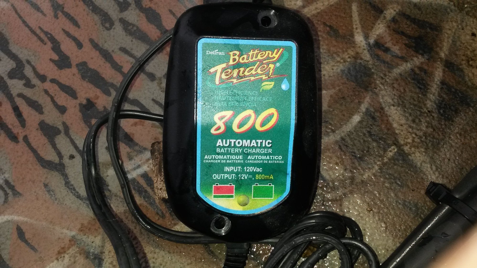

This is the model I use for my boat its exposed to the elements daily and is the model Battery Tender recommend for outdoor use.
Do we not need the tender on both batteries?

I've installed just the cable to the passenger side battery on my old truck as this was to be the main battery. Then I just hung it just out the hood so that I could just plug in with out opening the hood. I have not attached the harness to my 17 as of yet but I will soon. They make a small weather proof tender if it's going to be outside, but I would plug the extension into a ground fault just to be safe.
The batteries are electrically connected, so connecting to one is also a connection to the other. No need for two connections.
No. Since the batteries are connected in Parallel you only need to connect to one battery. Running your batteries in parallel doubles the capacity (amp hours) of the battery while maintaining the voltage of one of the individual batteries.
