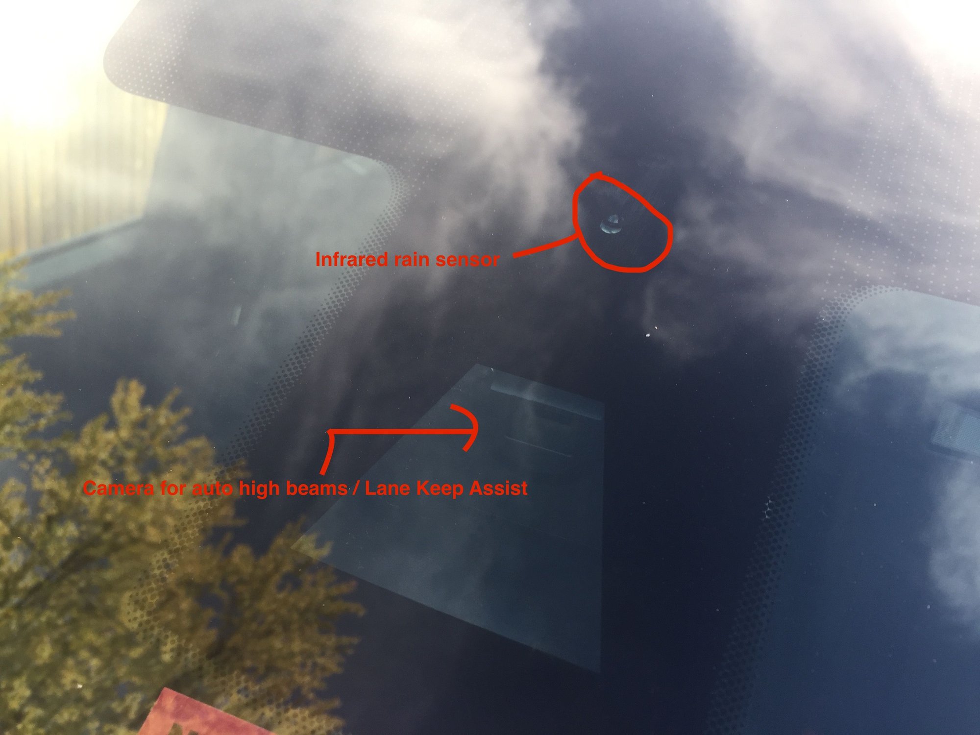

The rain sensor is mounted highest on the windshield and would definitely be affected by a tint. It is an infrared sensor. Auto high beams and Lane Keep Assist is a camera and mounted a bit lower. Once again, a tint would affect function.
Auto headlight on/off and the climate control solar load sensor is mounted on the top of the dash behind the center speaker right at the windshield.
Here's a pic of mine, hope it helps.

It shouldn't be affected unless you tint the outside of the windshield or run it behind the interior fairing that covers the cameras.
