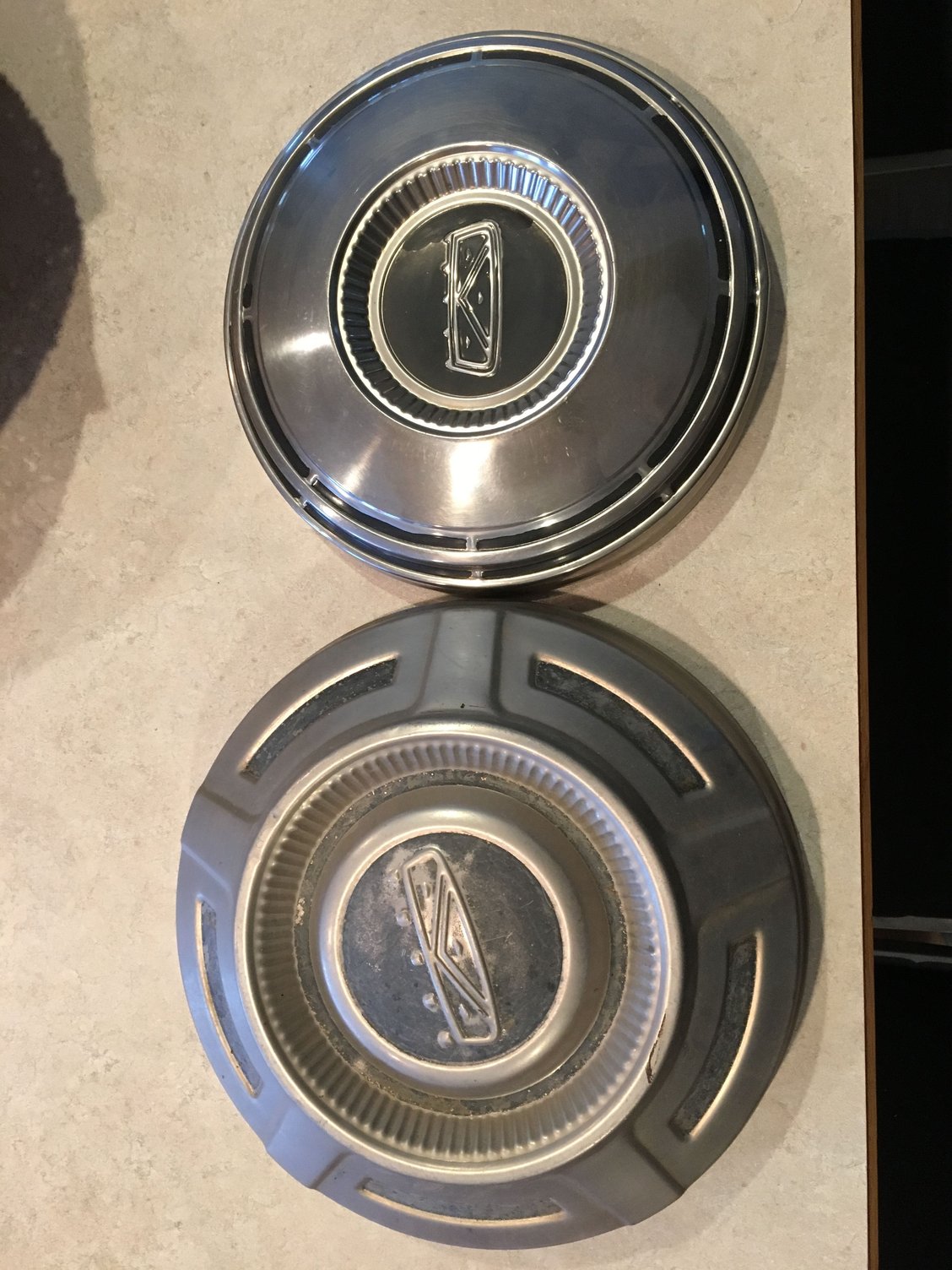

that's what i thought, how do you transform what i have to what you have?
thanks dave
Those in your pic appear to be painted...?

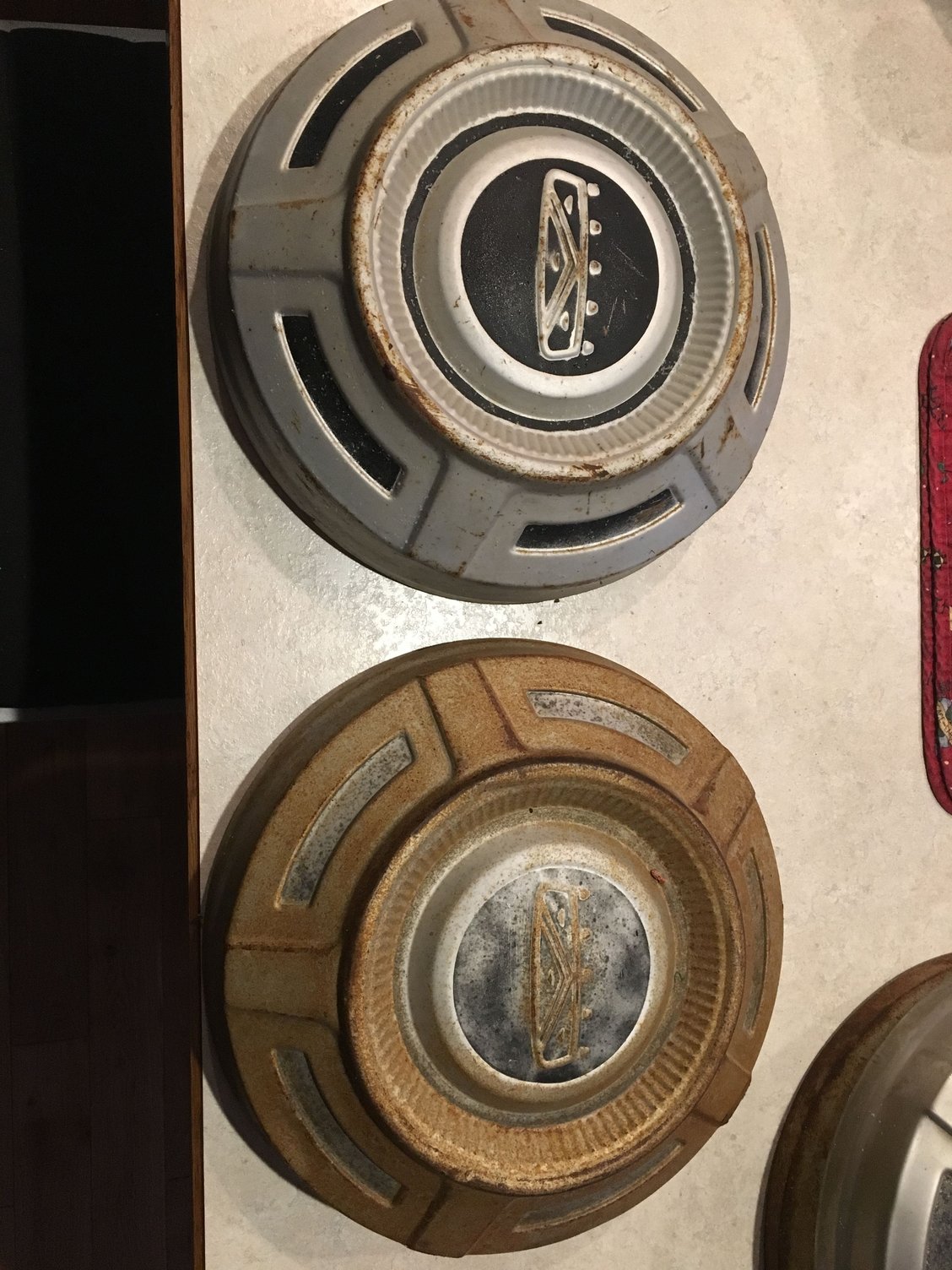

Base trim models got painted hubcaps
"that's what i thought, how do you transform what i have to what you have?" Unfortunately, it's not possible. Your rust-discolor hubcaps are painted steel. The bright ones are stainless steel.
In general, the base models with painted grill and bumpers received steel hubcaps with silver/black paint. Models with the bright grill, bumper, and trim got the stainless steel hubcaps. Stainless steel hubcaps were placed on wheels painted the main body color, steel hubcaps on white or, later, grey wheels.
But Ford never delayed shipping trucks on account of hubcaps, so occasionally you'd see new trucks delivered with the stainless hubcaps on painted wheels, less frequently painted hubcaps on body-color wheels.
Several of the spray can paint brands supply "stainless steel" and "nickel" paints that look nice on the steel hubcaps. Either sandblast or apply Ospho rust converter, then prime, then paint. The black contrast areas on both hubcap types are somewhat difficult to repaint, best done by using a diluted oil-base flat black applied with an art brush in "drops" that spread on contact. Time and patience are required, but the results are superior to masking and flat-black spray painting.

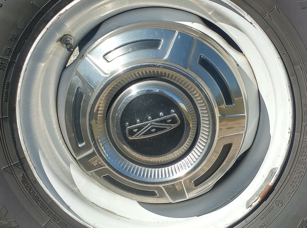

did you redo yours wj?
No, original owner took good care of 'em.

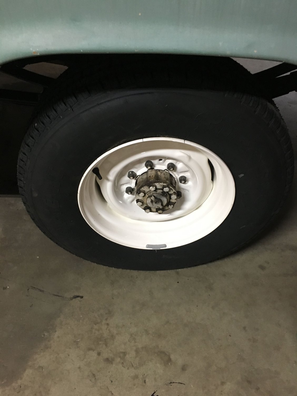

thanks farmall, great info, my wheels are 16.5 on my camper special, looking for opinions, would you all do stainless steel or paint?

Thumbs up Wheels look great!
And the color looks very close to factory original. I'd try painting the ones you have. Either color I mentioned will look very nice as contrast to your white wheels.
You could keep your eyes open for a nice set of stainless steel hubcaps, but they're pretty expensive unless you luck onto a set at reasonable cost. In the meantime, you'll be pleased with your repainted ones, I'm quite sure.
