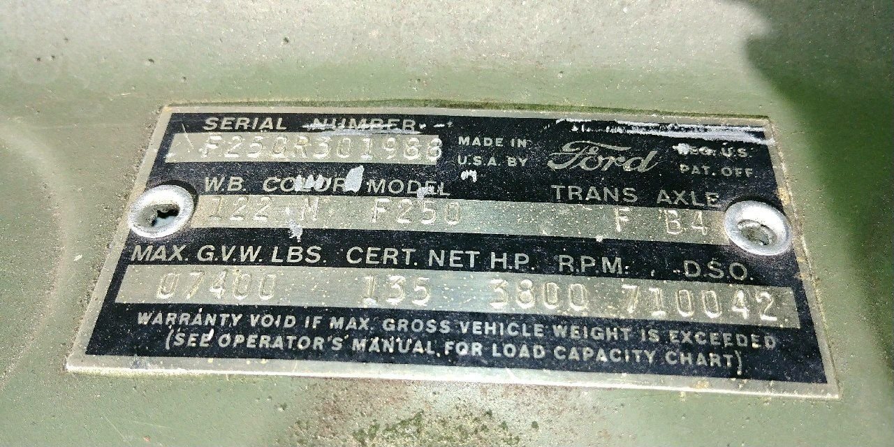

Hello All! New to the forum as well as the old ford truck world. Been looking for an old F100 for years and finally bought an F250 this week. I've been searching the forum and web for help decoding the VIN and have gotten most of this figured out. The one thing I'm struggling with is the year. I believe it is somewhere in the "301988" part of the serial but can't figure out how to tell. If anyone can help or maybe point me in the direction of help it would be greatly appreciated! I'm not sure what color "M" is either but I'm mostly concerned about figuring out the year at this point. Thanks

I can give you a full decode. Back in a bit.
F25 = F250 2WD
C = 292 2V
R = San Jose CA Assembly Plant.
301988 = 1962, assembled June 1962.
122" Wheelbase.
M = Corinthian White.
F250 2WD .. 7,400 lbs. GVWR
F = Borg-Warner T-98 4 Speed Manual Transmission.
B4 = Dana 60 Rear Axle / 4.56-1 / Limited Slip / 5,200 lbs. Rear Axle Capacity.
7,400 lbs. Gross Vehicle Weight Rating.
135 net HP @ 3,800 PRM
710042:
71 = Los Angeles (SoCal) Ford District Sales Office, where the original selling dealer ordered the truck from.
0042 = Domestic Special Order number, truck ordered special by the original purchaser, not "bought off the lot."

301988 decodes as 1962 model built in June 1962.

Thanks for the quick help everyone.
