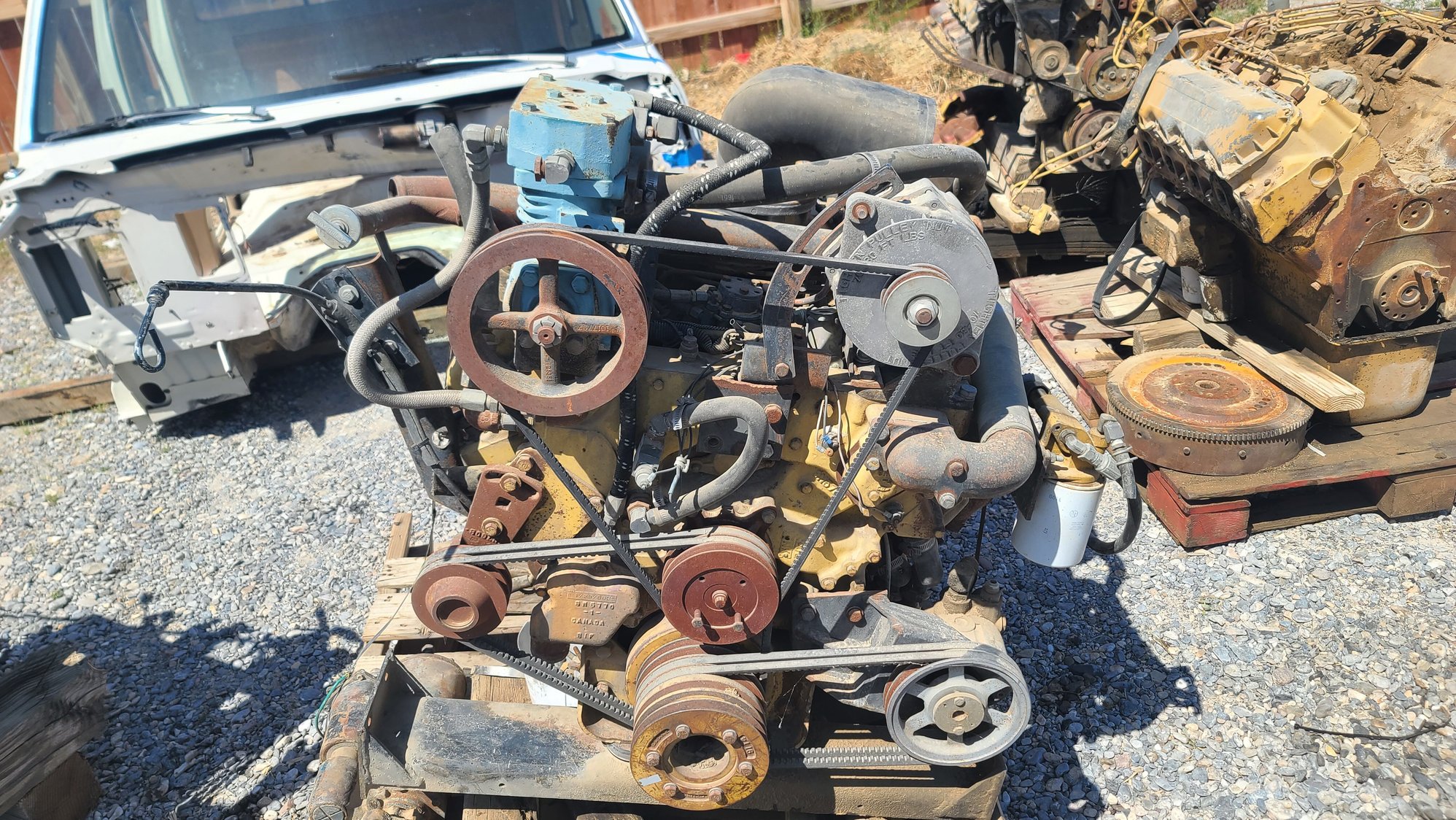

I'm putting a 86' F800 hood and Crew Cab onto my 2015 international chassis tandem axle (13.5k front 42k tandem)
with Cat 3208T 275hp and will mate RTLO16913 with 3.25 rear gears and full locker. Putting a 4 window collins Short bus body behind cab as a camper

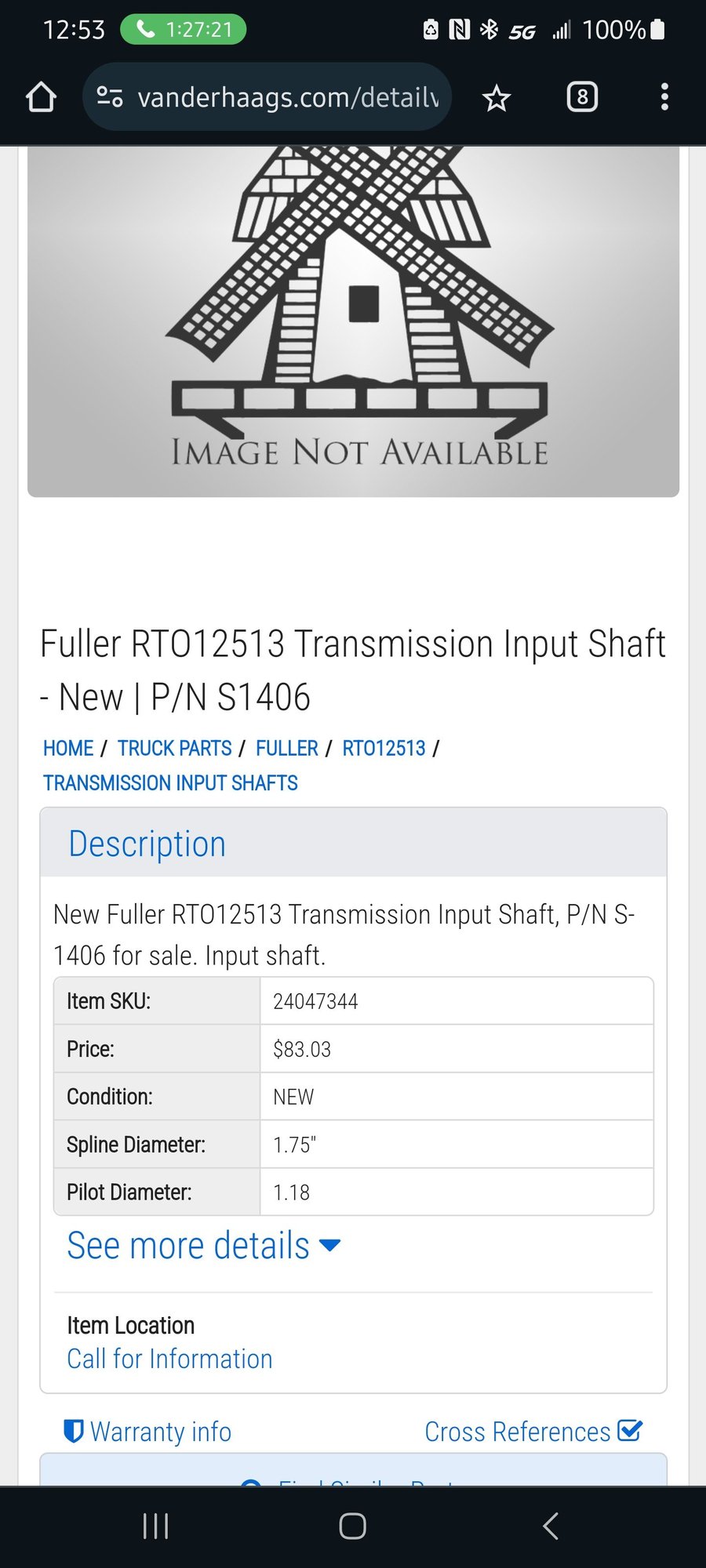

for your rto12513 you could go with a A3722 Bell and A S-1406 shaft 1.75-10 with 1.18 spline
